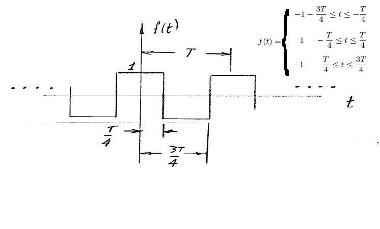

I need to determine the first three terms in the Fourier series pictured in the attachment.
Did I define the peace-wise functions correctly?
I'm re-posting this with the tex code instead of the attached document.

What is f?
lanedance said:
What is f?
It's not f. It's f(t), meaning f of t. If you look at the attached picture I came up with f(t) on three intervals. I'm not sure if they are correct. They look correct to me.
yeah i get its f(t) but can't see any attached pic? pretty important part of the problem
Sorry about that. For some reason it didn't attach. Here's another try at it.
ok, so why integrate over more that a period?
3T/4 - (-3T/4) = 3T/2
I think that's where I might of made the mistake. I think I should of done it from -T/4 to 3T/4.
That sounds better... Note that the integral over sin(tnpi/T) would be non zero over that interval as well, you could try your new interval on a sin as a check
