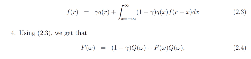

preparation for exams in EE
below
It looks like a mistake, the book writes the following:
I believe (2.4) should be: ##F(\omega)=\gamma Q(\omega)+(1-\gamma)F(\omega)Q(\omega)##. I don't understand these pitfalls in books, they don't make someone to proof-read the text?!
I mean besides me the reader... of course. :-D
"The book" is not really a great reference, What book and what page? Jeez
Yes, I think so too.
