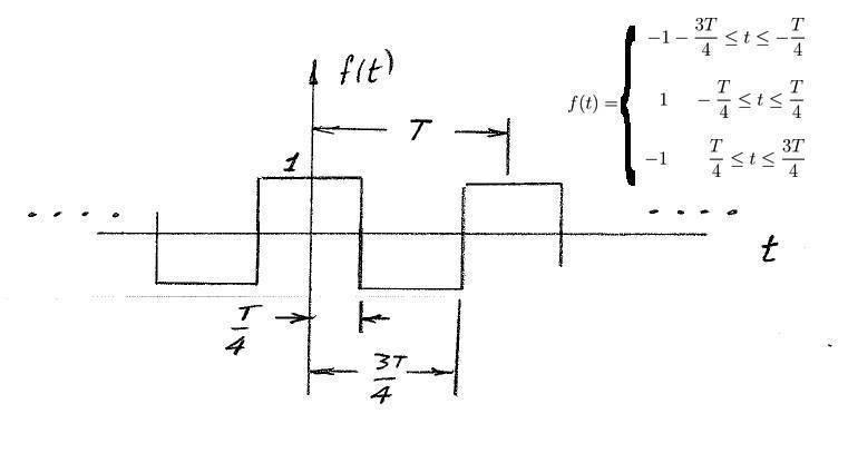

Determine the first three terms in the Fourier trigonometric series for the function shown below.
Look at attached jpeg. This tex tool is terrible. After making correction to the code, the preview still shows previous preview posts.
See attached jpeg for solution and the other attachment for the function. Did I define the function correctly? I didn't solve for bn because this function is symmetric about the y-axis.
First three terms mean a0, a1, and a2 right?
Or is it n=1, 2, 3

Would anyone check this for me please?
