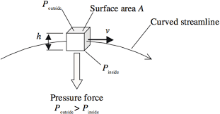

Pressure gradient normal to the local flow direction balance the centrifugal force associated with the curvature of flow..
Which centrifugal force inertial or "reactive" centrifugal force?

There is no centrifugal force in your diagram.

The diagram apparently shows the inertial frame where there is no inertial centrifugal force on the fluid piece. The text seems to talk about a rotating frame where the centripetal net pressure force is balanced by an inertial centrifugal force.

From the non-inertial frame of reference of an observer moving with the parcel of fluid, the centrifugal force is directed to the outside of the arc, and the force balance reads: $$P_{outside}A-P_{inside}A-F_c=0$$where $$F_c=m\frac{v^2}{R}$$with R representing the radius of curvature of the arc.

How you would write equation for inertial frame?
(Pout - Pin) x A = Frcf ?
Frcf= "reactive centrifugal force"...Frcf=mv2/R

The 2nd Law equation for the parcel of fluid in the inertial frame would be:
(Pout - Pin) x A = Fcp
Fcp= "net centripetal force"...Fcp=mv2/R
The equation for Frcf that the parcel exerts on the neighboring parcels would be:
Frcf = -Fcp
