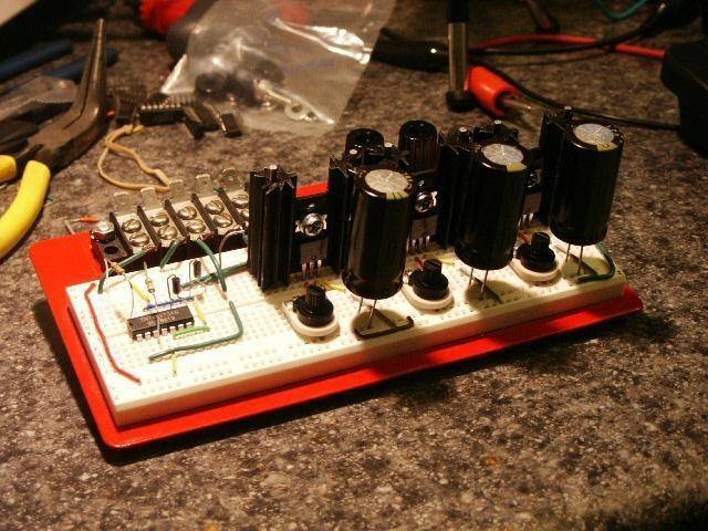

Hello All,
I've been working on making a special three-channel pulse circuit that has three harmonic outputs using a 7473 flip-flip IC. I am presently driving it with my function generator, which only goes up to 1MHz and I can divide the frequency down to 500 kHz and 250 kHz using the flip flip chip.
However, I am wondering if there is any kind of IC that does just the opposite of the flip flop, meaning that it doubles the frequency that you put into it? Ideally, I want to be able to control the thing with my function generator but be able to go up to higher harmonics then I am capable of reaching at the moment.
Thanks,
Jason O
I don't know anything off the top of my head, but conceptually, you can use your function generator to make a square wave, and then use a narrowband amplifier to amplify the higher harmonics.
Build a class C amplifier and tune the tank circuit to a harmonic of the input frequency.
Is there any way to make it variable? I made the flip-flop circuit so that I could dynamically vary all three frequencies by varying the signal generator input.
What you are describing is a phase-locked loop (PLL):
http://en.wikipedia.org/wiki/PLL
You make a PLL with a voltage-controlled oscillator (VCO) like a 74HC124 or more modern one, along with a feedback/divider circuit that locks a multiple of the basic oscillator frequency onto the fundamental frequency. Like, you could make a x8 PLL to give you an 8MHz output waveform that is locked to (and based upon) the 1MHz input frequency.
