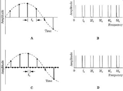

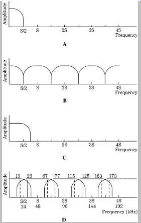

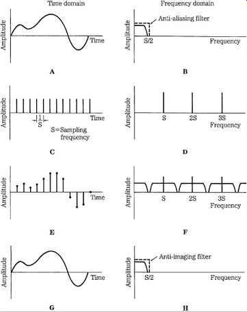

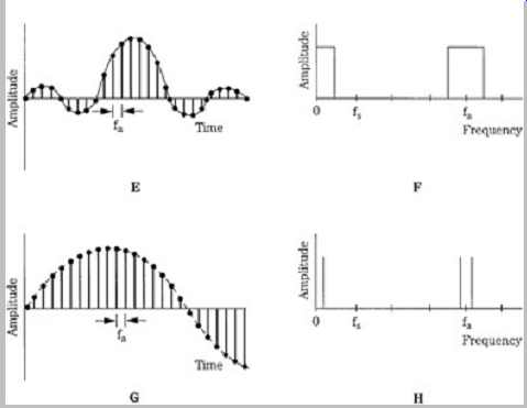

From Ken Pohlmann's Principles of Digital Audio (5th), here are some figures and their captions. I've emboldened all occurrences of term "image":
FGR. 2 Time domain (left column) and frequency domain (right column) signals illustrate the process of bandlimited waveform sampling and reconstruction. A. Input signal after anti-aliasing filter. B. Spectrum of input signal. C. Sampling signal. D. Spectrum of the sampling signal. E. Sampled input signal. F. Spectrum of the sampled input signal. G. Output signal after anti-imaging filter. H. Spectrum of the output signal.
FGR. 4 Spectral views of correct sampling and incorrect sampling causing aliasing. A. An input signal bandlimited to the Nyquist frequency. B. Upon reconstruction, images are contained within multiples of the Nyquist frequency. C. An input signal that is not bandlimited to the Nyquist frequency. D. Upon reconstruction, images are not contained within multiples of the Nyquist frequency; this spectral overlap is aliasing; For example, a 29-kHz signal will alias in a 48-kHz sampler.
FGR. 12 An oversampling filter resamples and interpolates the signal, using the impulse response; this is shown in the time domain (left column) and frequency domain (right column). A. The input signal is sampled at fs. B. The signal spectrum has images centered around multiples of fs. C. With resampling, zero-valued samples are placed between original samples at some interpolation ratio. D. The spectrum of the oversampled signal is the same as the original signal spectrum. E. The values of a sampled impulse response correspond to the coefficients of the digital filter. F. The transfer function of the filter shows passbands in the audio band and oversampling band. G. The digital filter performs interpolation to form new output sample values. H. The output-filtered signal has images centered around multiples of the oversampling frequency, fa.

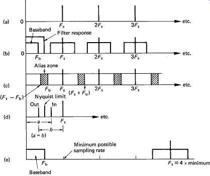

Below is an excerpt from another textbook on Digital Audio (The Art of Digital Audio [2001]):
FGR. 4 (a) Spectrum of sampling pulses. (b) Spectrum of samples. (c) Aliasing due to sideband overlap. (d) Beat-frequency production. (e) 4x oversampling.
In the same way that AM radio produces sidebands or images above and below the carrier, sampling also produces sidebands although the carrier is now a pulse train and has an infinite series of harmonics as shown in FGR. 4(a). The sidebands repeat above and below each harmonic of the sampling rate as shown in (b).
In FIGR. 4a, note how the "infinite series of harmonics " (i.e., images) maintain constant amplitude? Shouldn't the image amplitudes fade out naturally as the freq. gets further from Fs (i.e., original sampling freq.)? Or am I not understanding something fundamental?

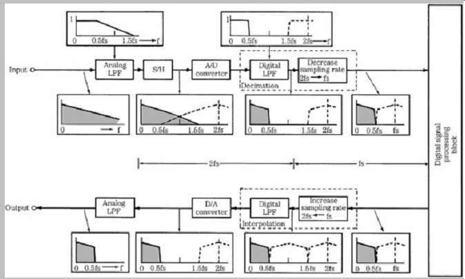

Tom.G said:
So, if you don't want extra high-frequency noise in the digitized data, filter it out beforehand. You can't do it afterwards.
I assume you mean in during the A/D process: i.e., use an anti-aliasing filter before the ADC.
Actually, modern ADC systems (e.g., as used for digital audio) use an analog anti-aliasing filter before the A/D converter (an IC chip). Then, following the A/D converter, an oversampling digital filter is used to "filter out" garbage introduced in the A/D.
