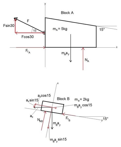

First of all here are my fbd's of block A and block B
Now for the math:

You have some mistakes and I think you are still not quite knowing what to do.
Start again but from this point of view: A and B are stuck together but B is about to slip. F is pulling the mass of both. So the result of whatever forces are acting on B is a horizontal force giving to B exactly the acceleration that F gives to A+B. With this in mind, draw your diagram being very careful with sin and cos and where to put right angles, these were some of the mistakes made before.
If you do all that, you should be in a good position to solve it.
sandman203 said:
Now for the math:
When stationary - Block A
ƩFy = mAaA = 0 = -49N + NA
What about NAB and FfAB?
When F is applied - Block A
ƩFx = mA × -ax = F cos30 + Ffa
Are you treating Ffa as negative? (You drew the arrow oppositely to F's)
ƩFy = mA × ay = 0 = Na - 49 + F sin30
Again, what about NAB and FfAB? As I suggested, it's simpler to treat A and B combined instead of A in isolation.

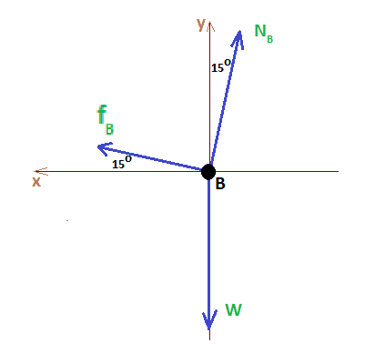

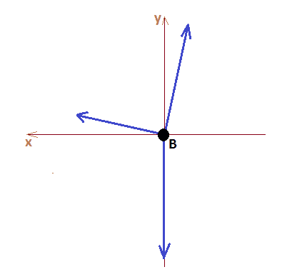

If you consider the forces on B alone, you will be able to determine the numerical value of the acceleration of the system that will put B on the verge of slipping.
See if you can complete the free body diagram of block B that I have attached here. I leave it to you to identify the forces (blue vectors) and the appropriate angles.
As pointed out before, it will be best to choose the x-axis horizontally and the y-axis vertically.
Since we are assuming that B is on the verge of slipping there is a relationship between the friction force acting on B and the normal force acting on B.
What can you deduce from [itex]\sum[/itex]Fy = may ?
Then, what can you get from [itex]\sum[/itex]Fx = max ?

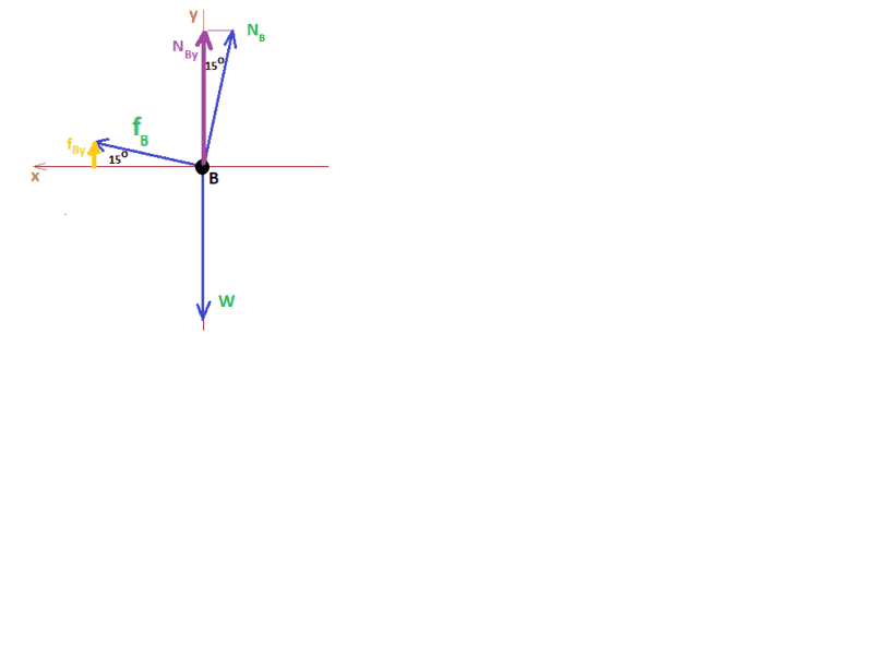

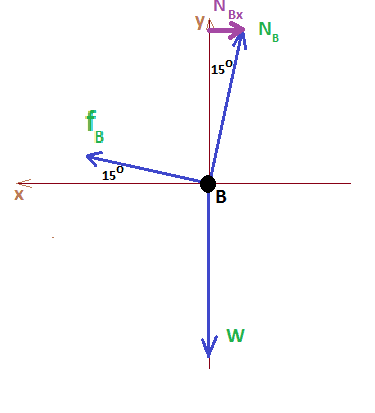

Please set up the equation [itex]\sum[/itex]Fy = mBay for the diagram I posted for B. That will allow you to find the numerical value of the normal force that A exerts on B.
ok so for block b ƩFy = 2×-gcos15 = -Fsin15 + NAB +2×axsin15??
Note [itex]\sum[/itex]Fy = may means
NBy + fBy + Wy = may where W is the force of gravity, fB is the friction force on B, and NB is the normal force.
Keep in mind that in the free body diagram for B, we are choosing the y-axis vertically. Does block B have any acceleration in the vertical direction?
ahh no it has none, otherwise it would lift off the block or go into block A. right?
Right. We are considering block B when it is just on the verge of slipping (but not yet slipping). So, yes, block B does not move vertically at all and ay = 0.
Now, how would you express NBy in terms of NB and the angle of 15 degrees?
How would you express fBy in terms of fB and the angle of 15 degrees?
How would you express Wy in terms of mB?
