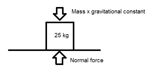

The problem seems very straight forward, however it's proving stubborn. The problem is as follows: We have a mass of 25kg sliding on a table with a frictional coefficient of 0.36. What is the frictional force in Newtons? Now, I know the force of friction to be Fƒ = μmg and also Fƒ = μmg⋅cosα, but the angle in this case is 90 degrees, so I immediately ruled the second equation out. To me, this should be Fƒ = (0.36)(25kg)(9.81) = 88.29 Newtons of frictional force, but that apparently is incorrect. Any input on what I may be doing wrong, but may not understand about this process in general?

Hi Josiah, perhaps a diagram would make things easier to visualize:

The normal force is equal to mass*g if we know that there aren't any other forces acting in the vertical direction on our object.
You have stated the object is moving 'sliding' in the original problem. It's important to know if the 'sliding' force is purely horizontal or not.
So your first step is to figure out what the normal force is, and this will be dependent on whether the force applied to make the object slide has any vertical components.
When you know the normal force, you can then apply the relevant equations I have given above.

The kinetic friction between two surfaces is ##\vec f = -\mu_kN\vec v/v## where ##\vec v## is the velocity of the sliding object, and ##\vec N## is the "normal force" - it acts perpendicular to the surface, and is usually what stops the object from falling through the surface.
This equation is saying that the friction has magnitude ##f=\mu_kN## and acts in the opposite direction to the motion.
You have to derive the equation for each specific case - which you do by drawing a free body diagram and using Newton's Laws.

I note that the problem statement says nothing about the velocity, acceleration or any other forces acting on it . Is that correct?
If so then I believe your answer is correct. Perhaps try g=10m/s/s rather than 9.81m/s/s ?
... or 9.8m/s/s ... if this is a computer marked thing, they can get very fussy about exact answers, to the correct number of decimal places.
