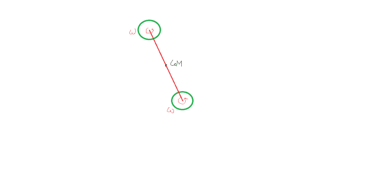

I first tried to analyse the problem. When the brakes are applied then the wheels stop spinning and as these forces are internal forces, if we consider bike as a system, so they can not brought deviation in the trajectory of the CoM of the system.
As these are internal force so we can conserve angular momentum of the system about its CoM. This will give the magnitude of the angular velocity after the brakes are applied. We can also conserve ttotal energy of the system.
Am I right??
When brakes were not applied till then the bike was not rotating about the its CoM. So the orientation of the bikes remains same.
Diagram of a bike modelled as a rod, with a red line joining two green-circled wheels labelled ω at the upper wheel and ω at the lower wheel, and a small dot labelled CoM at the midpoint.
As the wheels were not rotating about the CoM of the bike before the application of the brakes. So the velocity of the CoM of the wheels wrt the CoM of the system is zero.
Now the angular momentum of the wheels about the CoM( let it be point O) of the frame is equal to
Angular momentum of the CoM of the wheels about point O+Angular momentum of wheels about its CoM.Now the 1st term is zero be cause the wheels were not rotation about point O. So
Initial angular momentum is ## 2I_{w}\omega##.
When the brakes are applied then whole bike would start rotating about the CoM of the bike. Let the angular velocity be ## \omega_{0}##.
So Final Angular momentum is ##I_{system}\omega_{0}##.
So ##I_{system}\omega_{0}=2I_{w}\omega##.
After that I would get a constraint relation that the bike have to rotate 538 deg. in the time laft to land on the ground. I mostly make mistakes in conserving Angular momentum. :confused:
Have I done correctly this time?:oops:
EDIT: I have taken Counter Clockwise as +ve while calculating ##L##.
All looks right so far, except that work will not be conserved when the brakes are applied. But you don't seem to have used that anyway.
So,
##I_{system}=\frac{ML^2}{12}+2 \left( m{ R }^{ 2 }+m{ \left( \frac { l }{ 2 } \right) }^{ 2 } \right) ##
##I_{w}=mR^{2}##
So on putting these I got
##\omega_{0}=0.3v##
Now time period of projectile is
##\frac { 2v\cos { \phi } }{ g } ##
Time requires by wheels to rotate 538 deg. =## \frac { 269\pi }{ 90(0.3v) } ##
So Answer is ##\frac { 2v\cos { \phi } }{ g }- \frac { 269\pi }{ 90(0.3v) } ##.
I think I need the value of 'v'. How should I get it?
You mean, the time required for the whole bike to rotate, yes?
It isn't made clear, but I assume the start point is when the front wheel leaves the ramp. That makes it symmetric with the landing position.
Consider the horizontal morion while airborne.
