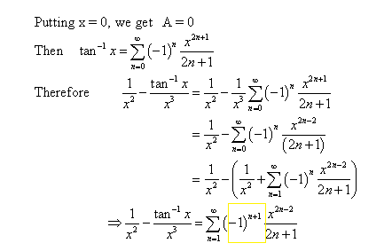

If you don't mind me asking one more question, I am stuck as to how they got the last line of this solution to another problem.
From what I can tell, they plug in n=0 and got 1/(x^2) and then changed the power series to n=1
1/(x^2)-1/(x^2) cancels out and disappears. The thing I don't understand is how (-1)^n becomes (-1)^(n+1)
What am I missing here? The answer in the back of the book has it as well.
There's a negative sign in front of [tex]tan^{-1}x.[/tex] They bring it into its power series formula, thus raising the exponent on -1 to n + 1.
