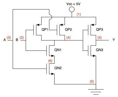

This is a very nice illustration of my point. The figure digoff posted is a perfectly valid AND gate but AND gates haven't been implemented that way in practice for more than 30 years! It just goes to show that even though the underlying technology changes, the logical basis for it remains the same. If looking at this particular implementation is helpful for understanding, though, it is useful.
In case you're interested, here is what a modern "practical" AND gate looks like:
This is from: https://courseware.ee.calpoly.edu/~dbraun/courses/ee307/F05/index.html
The funny thing is, usually a circuit design engineer would "design" an AND gate like this:
assign out = in1 & in2; // this synthesizes to an AND gate
This is a snip of code in the Verilog Hardware Description Language. The vast majority of gate-level digital design (either in ASICs or FPGAs) is now done by writing hardware descriptions using Verilog or a similar language called VHDL. A program called a "Synthesis Tool" parses your Verilog code and creates a gate-level description of your circuit. A gate-level description means your design is now implemented in gates such as AND gates and Flip-Flops instead of computer code. Then another program called a "Place-and-Route Tool" uses already designed and characterized gates (called standard cells) to implement and hook up your circuit for you.

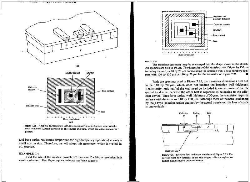

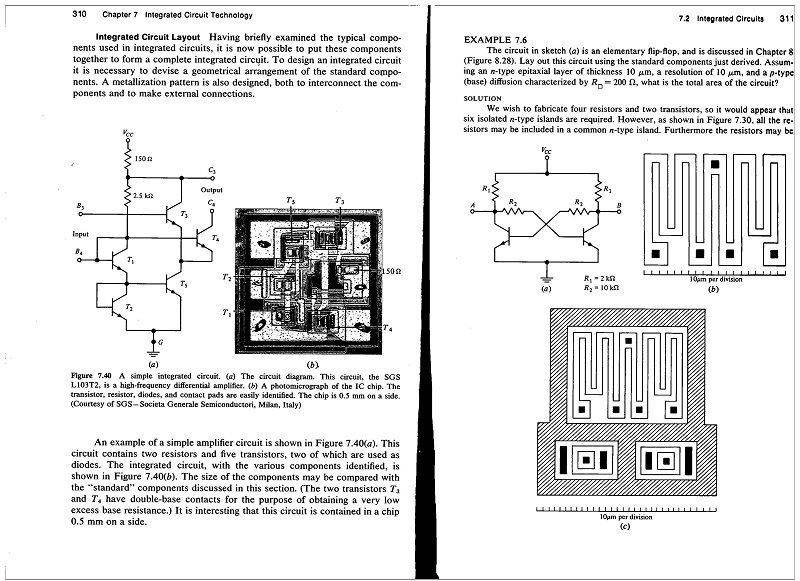

Nice find. The text I had for Electronics I (An Introduction to Electronics by W.G. Oldham & S.E. Schwarz) has a lot of similar transistor and IC fabrication images. Here's a couple of scans from it.

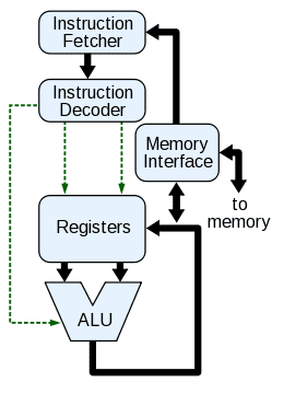

Understand electricity, understand logic, understand how logic can create a processor (basic CPU architecture) controlled by software, understand the peripherals a processor needs to become a computer.
If you want to jump ahead, this is a basic CPU: These basic elements are at the root of any computer. Just add IO (input output capability) to the external world.
(nice picture from http://web.sfc.keio.ac.jp/~rdv/keio/sfc/teaching/architecture/architecture-2009/lec02.html)
