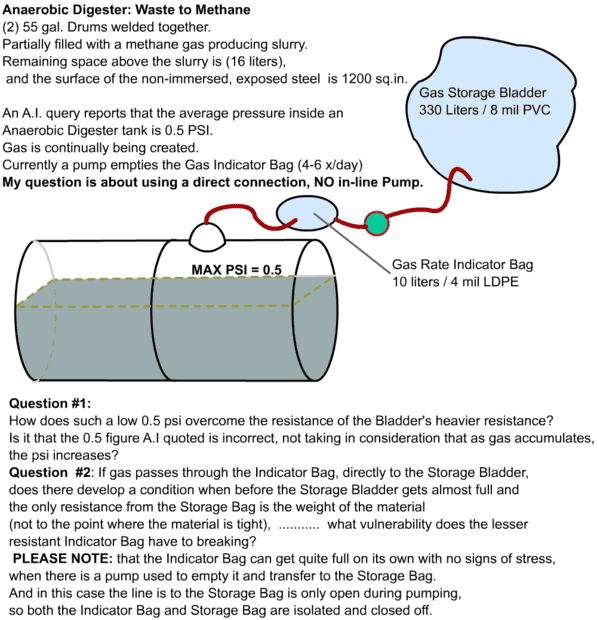

I've confused myself on Gas Physics. As to Pressure Equalization and Force.
I designed, built, and for 500 days run a solar assisted anaerobic digester.
I have two questions, one I think I know the general answer to but not the principals. The second question is more of a mystery to me.
Hi Physics Forum Folks! What an amazing resource of knowledge, ... thanks!
The question is on the attached graphic, as its much more clear with an illustration.
(Please read questions on this graphics first before looking at the video below,)

I'm not 100% certain that I understand your question, but:
For 2 bags "in series" the pressure will be the same.
Pressure and force are related, but different. 0.5 PSI can produce a lot of force over a large area - that pressure should be more than sufficient to 'inflate' your heavy bag. I would expect the indicator bag to show signs of "inflation" first - the lighter material requires less force/area (pressure) to lift it.
I'm not sure which bag is the "weakest link" - that depends on the design of the bags. You can determine that empirically with a simple pressure test.
I guess the concern is the smaller bag has a breaking point that's less than the bigger bag, ... but if I don't fill the bigger bag to the point that it is physically stretching and creating a "back pressure" on the smaller bag, how does that affect the pressure on the smaller bag? If I keep the the big bag at slightly less than fully inflated (pumping that gas to a much larger storage bladder that is isolated from this system) does the system exist at just slightly above atmospheric pressure, ..... and maintaining the small bag intact?
Yes. Some small "back-pressure" will exist at any level of inflation of the large bag. I wouldn't expect a problem with the large bag less than "fully inflated,"

In terms of gas pressure, I guess I'll temporarily bypass the pump, and keep an eye on it!

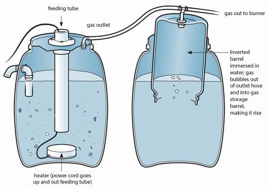

Are inverted bucket generators or storage containers an option to be considered?
I like those, because are capable of maintaining a constant internal pressure and flow in a wide range.
YES. When I was in Shenzhen working with the guys from the Puxin company (a GREAT supply resource especially for smaller "home scale" digesters) , they used a technique similar to yours, but kind of reversed from your illustration.... they have an inverted fixed dome in a cylinder of water, and the water goes up and down, not the cap. But its an eloquent piece of engineering, by using the hydrostatic pressure, they don't use any pumps for gas, but can still modulate pressure (I went there in 2009 I'll see if I can find a video of he actual component. Now the ones we got from them were 4 ft in diameter and 5 ft high and concrete. I got the steel molds for them and the 200 cu. meter tanks from them as well as the fiberglass caps for the gas "bells". The drawback was you had to replace your moisture traps for the gas quite often because of the contact with water, the water level in "bell jars" had to be controlled by auto fills, or monitored because of evaporation, and for those who were new to it, we wanted to be able to see the gas produced in real time. its still a great idea though. Every engineering advantage comes with a price.

Hi Lnewqban,
If someone recreates your digester model illustration, my suggestions are:
1) Suspend your heater a little higher. The sludge especially with a vertical geometry (my preference is horizontal tanks) .... will gather quickly at the bottom covering up your heater. Also to choose the right heating element (I shopped aquarium equipment) .... decide if you are gong to cultivate methanogen microorganisms at "mesophilic" temperatures (20C - 45C ) or "thermophilic" temps (45C 1222 C), in order to set the heater controls correctly. Quick changes can kill the tank.
2) Here's the one that I learned the hard way: Put an anti-siphon hole in the outlet port at the top of the bend. Without it the first time you load the digester a little too quickly, you'll siphon your slurry out of your tank to the lowest level of your interior exit pipe, with a 50/50 chance of sucking oxygen into your tank ............... like I did.

Oh! And just to push the solar heating as the best medium ...... calculate (A) the energy created by your electric heater, THEN calculate (B) the energy value of the methane that the little tank creates, ... and subtract A from B and hope for a positive number!
