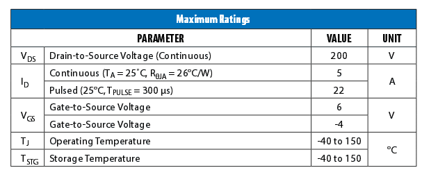

I am interested in using GaN MOSFETS for my circuit and I'm looking at the EPC2012C. I'll attach the datasheet here. I noticed that it calls for a -4 Vgs. If my driver only goes to 0 V, will this cause a problem? What is the benefit in driving negative if it's not required?

That looks to be the lower limit of the Absolute Max Ratings...

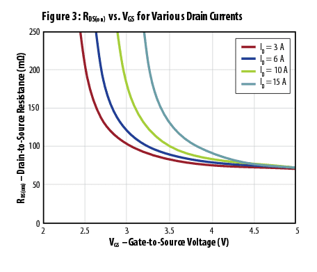

Maybe check out the other characteristics in the datasheet, like this one:

It looks like that plot shows Rds for turnon voltage so I can see that going to +5 Vgv on gives lower Vgs than say 3.5 V but I don't see a plot or anything discussing turnoff voltage which is negative...(-4 V) at the lowest.
Vgs = -4 V is only during a Gate-to-Source Reverse Leakage test.
With Vgs = zero there may still be some drain current, maybe up to 1 mA.
In some cases there is a benefit in having a gate driver try to drive the gate more negative than the DC curves in the datasheet imply. This is in response to the fact that the actual gate voltage during transitions is a dynamic thing, so "overdriving" sometimes helps. The point isn't that you need the real Vgs to be negative, but that you want it to get to zero faster, or you want it to stay at zero.
The classic problem is the Cdg (Miller) capacitor, which will inject current into the gate during switching due to high dv/dt at the drain. Weak gate drive can make for slow switching because you can't charge the Cdg cap fast enough.
Frankly, I think this is more common in Si devices because they are inherently slower devices (high Cdg). I never really looked at this in GaN devices.
There is a similar problem with source inductance and high di/dt. I recall one app engineer say that GaN TO-220's were pointless because the package had too much inductance in the leads to allow the transistor to switch fast enough.
