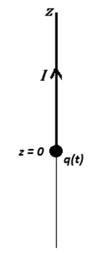

Imagine a charged sphere at the origin connected through an open switch to a vertical grounded wire.
We wish to find an expression for the horizontal component of the electric field at a distance ##\mathbf{r}## from the sphere as it discharges.

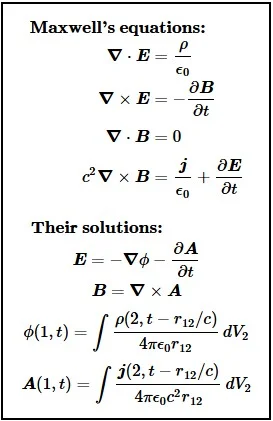

Imagine that we have two long vertical wires connected either side of a charged sphere.
We connect the two wires to the charged sphere simultaneously so that it is discharged by equal and opposite currents.
Using the Lorenz gauge ##\nabla\cdot\mathbf{A}+(1/c^2)\partial \phi/\partial t=0##, Maxwell's equations have the following retarded wave solutions in the scalar and vector potentials.
Starting from Gauss's law
$$\nabla \cdot \mathbf{E}=\frac{\rho}{\epsilon_0}.\tag{1}$$
We substitute in the potentials to give
$$\nabla \cdot (-\nabla \phi - \frac{\partial \mathbf{A}}{\partial t})=\frac{\rho}{\epsilon_0}.\tag{2}$$
Now for every contribution to ##\frac{\partial \mathbf{A}}{\partial t}## from an element of current density ##\mathbf{j}## at position ##(3)## on the upper wire there is an equal and opposite contribution from an element of current density ##\mathbf{j}## at position ##(4)## on the lower wire.
Therefore the scalar potential ##\phi## at point ##(1)## is simply due to the charge density ##\rho## on the sphere at position ##(2)##:
$$\nabla^2 \phi=-\frac{\rho}{\epsilon_0}.\tag{3}$$
Poisson's equation ##(3)## has an instantaneous general solution given by:
$$\phi(1,t)=\int \frac{\rho(2,t) dV_2}{4\pi\epsilon_0 r_{12}}.\tag{4}$$
This is different from the expected retarded solution for the scalar potential wave equation:
$$\phi(1,t)=\int \frac{\rho(2,t-r_{12}/c) dV_2}{4\pi\epsilon_0 r_{12}}.\tag{5}$$
What is the reason for this discrepancy?

Suppose we have a steady current ##I_o## along the positive z-axis that has existed for a very long time and then ceases everywhere at time ##t = 0##. Let ##q_0## denote the charge that remains at the origin at ##t = 0##. So, ##q(t) = q_o – I_ot## for all ##t<0## and ##q(t) = q_o## for all ##t \ge 0##.

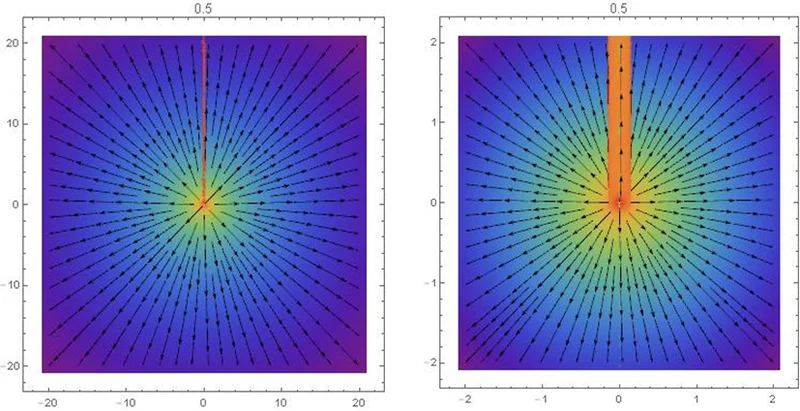

I created some streamline plots of the electric field at various times. I chose the unit of time to be a nanosecond and the unit of distance to be a meter. (The speed of light is 0.3 m/ns.) The number at the top of each graph is the time in ns for the plot. These are streamline plots where the arrows show the direction of the E-field. The relative magnitude of the field is indicated by the background color. Purple is weakest, red is strongest. I chose values of ##q_o## and ##I_o## so that ##q_0 – I_o t## goes to zero at t = 1 ns.
For t = 0.5 ns
At this time, a strong pulse of ##\partial_t \mathbf{A}## has just been produced in the vicinity of the positive z axis. At most points in the graph, the field corresponds to a point charge at the origin with charge ##q_o – Iot = q_0/2##. The numbers on the axes are in meters. The graph on the left shows distances out to about 20 m. The graph on the right zooms in on the region about 2 m from the origin. If you calculate the total flux through a surface enclosing the origin, the flux will be ##q_0/\epsilon_o## in agreement with Gauss’s law.

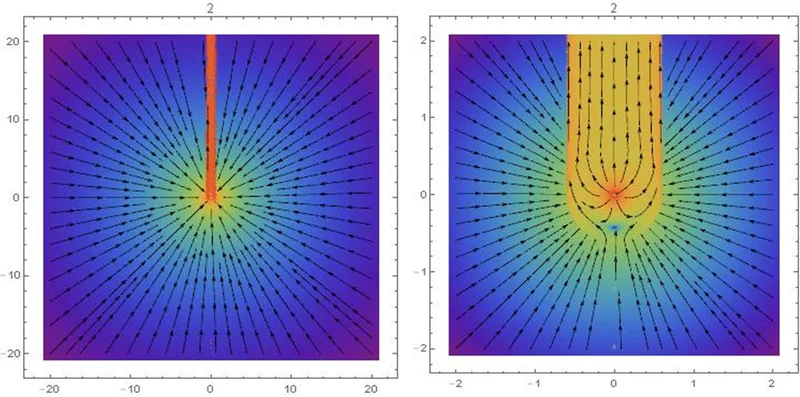

For time t = 2 ns:
The field now points toward the origin at most points due to ##q_0 – I_ot## becoming negative (##-q_o##). Of course, the actual charge at the origin at this time is still ##q_o## (positive).

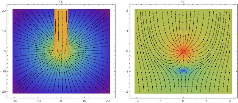

For t = 10 ns:
Near the origin, the field is beginning to relax to that of a point charge with charge ##q_0##. See the figure on the right.
The relaxation of the field to the field of a point charge ##q_0## takes quite a bit of time for distant points.

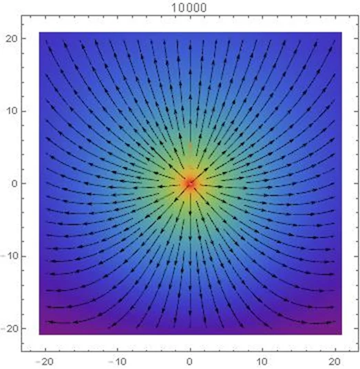

For t = 10,000 ns (or 10 microseconds)
At points greater than about 10 m from the origin, the field has still not relaxed to the field of a point charge.

I used Mathematica to plot the field.
