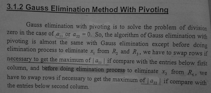

In my book , the author stated that when we do the pivoting , we need to make the element below the leading element = 0 . For example for 3x3 matrix , for the first column , we have to make a11 = max , and make sure that a21 and a31 less than a11 , for the second column , we have to make the a22 = max , make sure that the a32 less than a22 ...

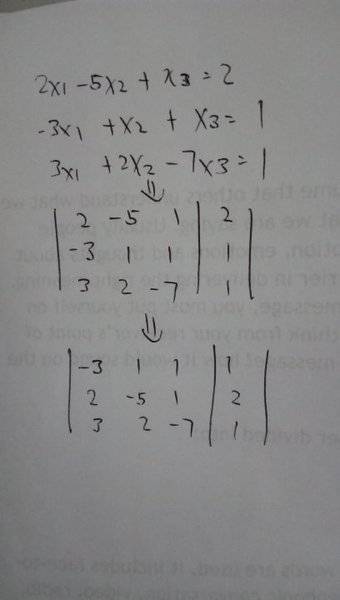

But , according to my lecturer ( in second photo)( I have reduced it into row echelon formed in first matrix , for the 2nd matrix , my lecturer just swap the row) , he make the a11 max compared to the other element( a12 and a13) in the first row ...
For row 2 , he make the a22 max compared to a21 and a23 in the same row
For row 2 , he make the a33 max compared to other element (a31 and a32) ...
I don't think the lecturer is correct . Can someone explain about it ? I have read a lot of online resource , i can't find them similar to the way that the lecturer read [/B]
  • Printed textbook page titled 3.1.2 Gauss Elimination Method With Pivoting, describing swapping rows to get the maximum absolute pivot entry before each elimination step.

  • Handwritten system of three linear equations, then its augmented matrix, then a row-swapped version of that matrix with the right-hand column of constants.

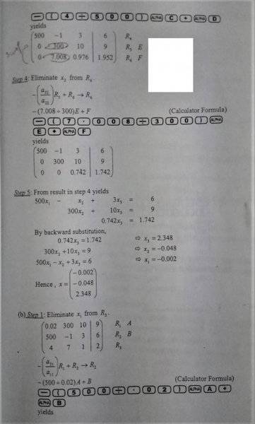

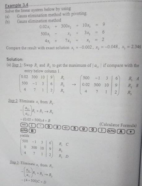

  • Printed worked example 3.4 solving a 3x3 linear system by Gauss elimination with partial pivoting, showing the matrix row swap for column 1 and the elimination step producing the reduced matrix.
  • Handwritten worked Gaussian elimination on a 4x4 augmented matrix with calculator key sequences, row operations R4 minus (a41/a31) R3 and a second elimination step, yielding an upper triangular matrix and back substitution giving x = (-0.002, -0.048, 2.348).
Not clear to me what your question is. I see a piece of text in hhh.jpg and a worked out pivoting example in 140116.jpg and 140126
Is 134955.jpg what you call 'the second photo' ? It only shows a swap of row 1 and 2 of a different matrix.
What is it you think the lecturer does incorrectly ? placing the -3 in position 11 is according to the text.

140116.jpg and 140126 are the textbook question . So , it follows the rule that stated in hhh.jpg

134955,jpg is the question that the lecturer showed and solved ... I didnt posted the full solution for 134955,jpg because i am just having problem with the pivotisation ( I doubt the way that the lecturer switching row is correct ) . After the pivotisation , it's just the normal gaussian elimination , followed by backward substituition to solve the question...
Why ? He picks the biggest ##a_{i1}## and moves that row to row 1

140116.jpg and 140126 shows that the author get the max a11 first , then he make the element below a11 = 0 , get max a22 , make the element below it = 0 ...
but , the lecturer gpot all the max a11 , a22 and a33 , then he only do the gauss elimination (make the element below a11 = 0 , make the element below a22 = 0 ... ) ...
Both method are correct ?

$$\begin{bmatrix}
2 & -5& 1 & 2 \\
3 & 2 & -7 & 1 \\
-3 & 1 & 1 & 1
\end {bmatrix} $$
The author then make a11 , a22 and a33 max all at ONCE , , hence , become
$$\begin{bmatrix}
-3 & 1 & 1 & 1\\
2 & -5& 1 & 2 \\
3 & 2 & -7 & 1
\end {bmatrix} $$In the 2nd matrix , we can see that all the a11 , a22 and a33 is max
Is the author's working of making all the a11 , a22 and a33 = max correct ?

I don't think so. In the 2nd matrix, as far as I can see, it just happens that a11, a22, a33 have the largest values (absolute values).
There are only three row operations that you can apply to get a new matrix with the same solution set as the one you started with:
1) Swapping two rows (Ri <--> Rj)
2) Replacing a row by a nonzero multiple of itself (Ri <-- k*Ri)
3) Replacing a row by the sum of it and a nonzero multiple of another row (Ri <-- Ri + k * Rj)
For the two matrices above, it looks like there were two row operations performed:
Rows 1 and 2 were swapped, resulting in
##\begin{bmatrix}
3 & 2 & -7 & 1 \\
2 & -5& 1 & 2 \\
-3 & 1 & 1 & 1\end{bmatrix}##
and in this new matrix, rows 1 and 3 were swapped, resulting in
##\begin{bmatrix}
-3 & 1 & 1 & 1 \\
2 & -5& 1 & 2 \\
3 & 2 & -7 & 1\end{bmatrix}##
The most important thing is that whichever row you're going to pivot on, the leading entry in that column should not be zero. You then use that entry to eliminate all the entries in the columns below that entry, with the goal being a more-or-less diagonal matrix, with entries of zero below the diagonal.
Keep in mind that all this matrix business is just a shorthand way to solve a system of equations. The same row operations apply; namely a) you can interchange any two equations; b) you can replace an equation with a nonzero multiple of itself; c) you can replace any equation with the sum of it and a nonzero multiple of another equation.
In all cases here, you end up with a system of equations that looks different, but has exactly the same solution set.

That was just an accident of the data in this problem.
Generally, we start in column 1 and move the numerically largest value in that column to position (1,1), perhaps by swapping some row i and row 1. Then we do row operations to zero out the remaining elements in column 1.
At that point the rest of the matrix changes (because the row operations affect all the columns, not just column 1.) So, what WAS a largest element before the row operations may no longer be the largest in the new matrix. Therefore, we cannot predict what further row-interchanges will be needed; maybe ##a_{22}## was the largest element in column 2 before row operations, but then maybe the new value of ##a_{42}## is the largest after.
I am trying to get you to understand that you need to re-examine the matrix (below the current pivoting row) that you get after the row operations. Basically, forget about what was largest in the original matrix and look instead what is now largest in the new matrix. It may have moved to a new location.

Yes , i understand what you said ...But , is the way of swapping the row all at once firstly to get max a11 and a22 , then , followed by the zero out the element below a11 and a22 correct ?
It is not incorrect, but it is a waste of time and nobody who writes linear algebra software (for example) would ever do it! The author should not have done that, unless it happened just by accident when he but the largest ##|a_{i1}|## into position (1,1) by swapping two rows. The fact that ##a_{22}## and ##a_{33}## are then also the largest is purely accidental and has no significance whatsoever. It is unimportant! Forget it!
You are trying to read way too much into things that have no importance, and it is getting in the way of your learning the subject.

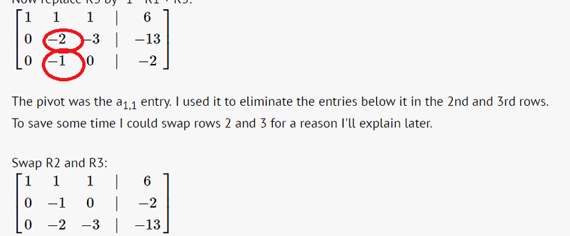

You do the above at each pivot row, moving across the matrix column by column.
Here's a simple system as an example.
x + y + z = 6
2x -z = -1
x + z = 4
As an augmented matrix this system is
##\begin{bmatrix} 1 & 1 & 1 & | & 6\\
2 & 0 & -1 & | & -1 \\
1 & 0 & 1 & | & 4 \end{bmatrix}##
Replace R2 by -2* R1 + R2:

I don't understand why you swapped row 2 and row 3 , at here , a22 is already max , why we need to swap row 2 and row 3 ? Swapping row 3 would make the a22 become not maximum ... To pivot 'a22' , we need to make it max , right ? Then , we can only make the element below a22 = 0
  • Two 3-by-4 augmented matrices from a row-reduction worked example; the top one has the entries -2 and -1 in column 2 circled in red, and the bottom one shows the result after rows 2 and 3 are swapped.
No you didn't misunderstand. Mark tells you: 'to save time'. Do it both ways and you already have found the explanation Mark gives a few lines later.
Note that swapping rows is for numerical analysis purposes only (one wants to avoid subtracting big numbers from big numbers) and it's no big deal NOT to swap an ##|a_{22}| = 2## of for one with absolute value ##1##.
sorry , i didnt quite understand the example that Mark gave in post #18...
Can you explain based on the example i gave in post #11 ?
Do you mean that it is actually unnecessary to interchange all the row at ONCE to get max a11 , a22 and a33 ?
We can also change the row to get the max a11 first , then zero out a21 and a31 , after that , change the row to get max a22 ... and so on ?
What parts of my example didn't you understand? I explained every operation in detail in terms of the row operations I used.
No, we're not going to do your work for you. Why don't you give it a try?
Not only that, as Ray said in post #14, it's not usually possible to get the largest values in a11, a22, and a33.
It's not necessary to have the leading entry of the pivot row be the maximum of the entries in that column. It's enough that that entry isn't 0.
In this image , I found that the gauss elimination with pivoting is suitable when a11 or a22 is 0 . But , based on the example I uploaded and discussed earlier , the a11 or a22 are not 0 , how could the author use the gauss elimination with pivoting ?
Mod edit: I inserted one of the images inline.
Printed worked example 3.4 solving a 3x3 linear system by Gauss elimination with pivoting, showing the row swap of R1 and R2 to put 500 in the first column and the elimination steps that follow.
  • Printed page titled 3.1.2 Gauss Elimination Method With Pivoting, explaining that pivoting swaps rows to get the maximum absolute pivot entry, |a11| and |a22|, before eliminating x1 and x2.
  • Handwritten worked example of Gaussian elimination with partial pivoting on augmented matrices, showing row operations to eliminate x1 and x2 and back substitution giving x = (-0.002, -0.048, 2.348).
What is so difficult to understand here? In the visible image of your post, they swapped rows 1 and 2. As I mentioned before, this is one of the three possible row operations. The next operation is to replace row 2 by -.02/500 * R1 + R2. This is another of the three row operations I mentioned. The a2, 1 entry in the second row will be 0 after this operation.
Then, what is the meaning of gauss elimination with pivoting is suitable when a11 or a22 is 0 ?
The you look at a33 as a potential pivot.
