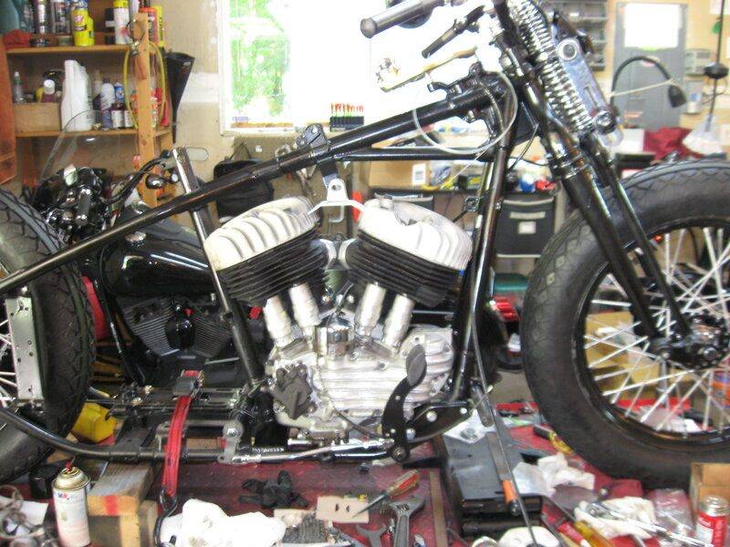

OK, you asked for it! Here's the engine bottom-end sitting in the frame, before I discovered that I couldn't get it bolted in. In the meantime, I've stripped the frame down completely, taking off the wheels, complete fork assembly, and any other pieces that were on the frame.
I took it down to the frame guy yesterday, and am hoping I'll be able to pick it up within a week or 10 days.
Quite a contrast between the two vehicles in the picture. The motorcycle engine is about as low-tech as you can get, flathead engine comparable to those in older lawn mowers, manual spark advance, kick-start only, with a very simple carburetor. Just behind it, double overhead cams, four valves per cylinder, variable valve timing, and fuel injection.

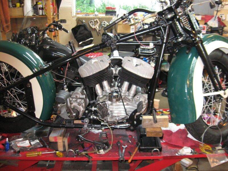

I got the frame back in a reasonable amount of time (9 days), and have started putting things back together. While the frame guy was working on the frame, I painted the forks where paint was needed. When I got the bare frame back, I spent some time tidying up the paint on it, sanding down places where there were chips, priming the bare spots, and rattle-canning most of the frame. My work came out pretty well, with no discernible runs.
The frame and forks are now back together, the wheels are back on, and the motor is bolted in. Next steps are to install the pistons, slip on the cylinders, and bolt on the heads.
Here are a couple pix of how the '45 looks at the moment.

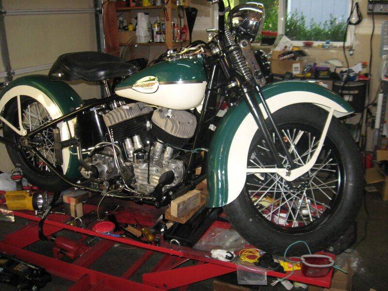

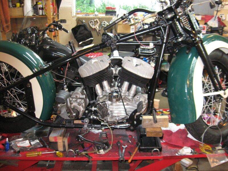

It's a slow process, but I'm making some progress. In the last month I had the frame straightened, and have installed the pistons, cylinders, heads, circuit breaker (which some mistakenly call the distributor), intake manifold, plus the feed oil pump. The feed oil pump sends oil to the engine internals, and another pump, the scavenge or return pump, sends the oil back to the oil tank. Except for the carburetor and torqueing the head bolts, the engine is pretty much done.
Another view of the whole bike as it currently sits.
I should get the remaining parts I need for the transmission, and then I can install the oil tank, exhaust pipes, and start wiring the bike. I'm hoping to get this thing running sometime in July.

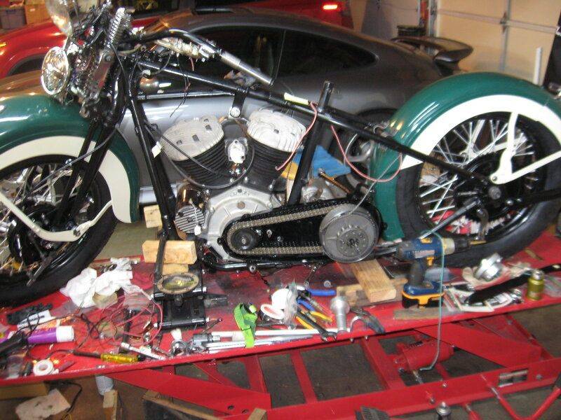

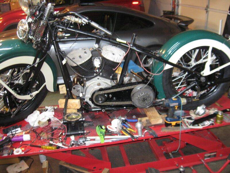

Here's the left side, with the primary chain and clutch in place. Still need to install the drive chain and chain guard.
It's looking really nice.
Here's the bike as of today. Oil tank is installed and plumbed, primary chain and clutch are installed and adjusted, and the drive chain is installed but not yet adjusted. The tanks are on for fitment purposes only, and the seat is just sitting there, not bolted in. I'll take both off to finish up the wiring. After I get the pipes installed, most of the rest is just small stuff.
I'll be out of town on two separate trips for much of the rest of August, so I probably won't get this running until September some time.

It's been about 15 months since I started working on the '45 Harley, but I finally have it running! I had some problems with a brand-new oil feed pump that wasn't making pressure, due to a defect in its manufacture and machining. I was able to refurbish an old one I had, and the engine is now putting out about 20 PSI, plenty for this old machine.
I'm still breaking in the engine, just starting it and letting it run until it gets warm, then shutting down. A few more heat cycles, and getting the timing (points ignition) and carb dialed in, and I'll take it for some short rides, like up and down my street.

This engine is air-cooled, which you probably knew, so there's more of a danger in overheating unless the bike is moving or without a fan blowing air on it. Pretty much everything is new - new pistons and rings in freshly honed cylinders, new cams (four of them!) and their gears and cam bushings, pinion and sprocket bearings and races. In addition, I wasn't sure I was getting oil pressure at first, but that's now squared away. I have three other running bikes, so I can take my time breaking this one in. Plus, the weather hasn't really warmed up all that much here in the Pacific Northwet -- we had a very nice day a week or so ago, 74 deg., but it has been very cool to the point of snow/sleet/hail more recently.
I expect to take it out for a spin within a couple of days...
