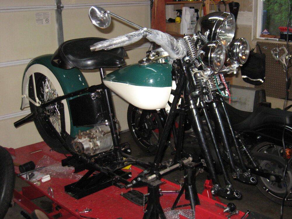

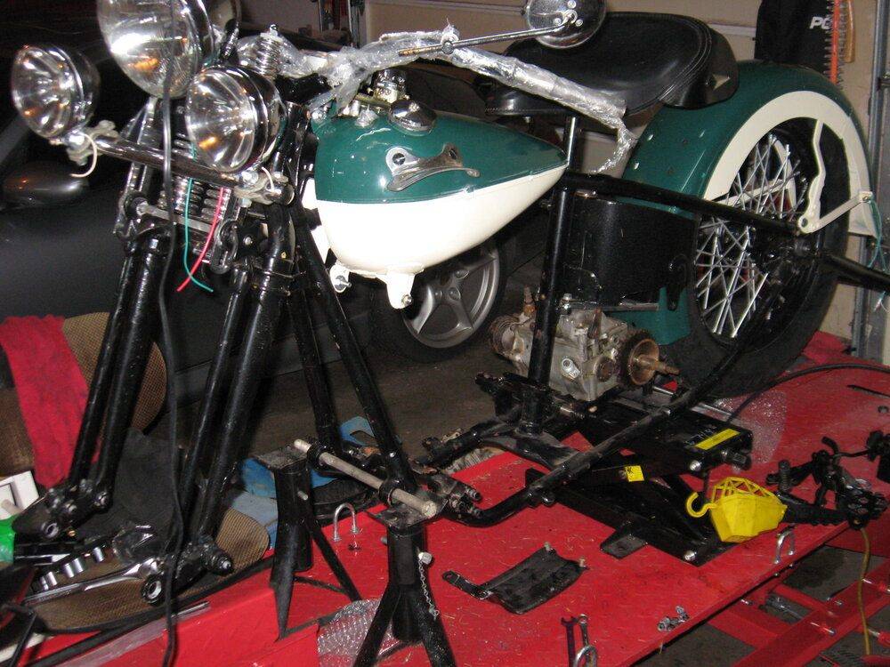

My current DIY project is the 1945 Harley-Davidson UL. The engine is a "side valve" AKA flathead, similar to the ones in older lawnmowers. Pretty low-tech, with manual advance points ignition. Not shown in the pictures are the engine, which is missing a lot of parts, but does include a bunch of parts that are too far gone to use or aren't for this bike.

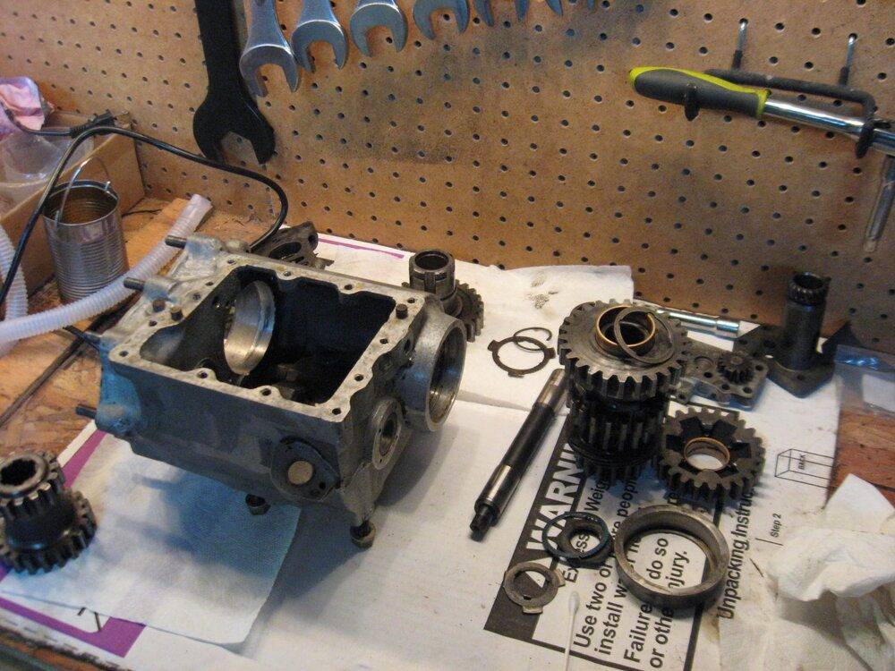

The transmission appears to be in good shape, but I have it all apart for cleaning and replacement of any parts that should be swapped out. The bike came with both wheels and new tires, but was missing the brakes and associated linkages, as well as the clutch, primary chain and drive chain, generator, all of the wiring and control cables, fuel lines, oil lines, and many more parts.
The front wheel and fender aren't shown, but I have them. The fender has the same paint scheme.
The engine isn't shown. A friend of mine who just retired from a machinist job and who also has a similar bike of slightly older vintage is helping me get the engine back together. I'm hoping that this thing will be running in 6 months, but it could possibly take a fair amount longer. Although the bike is missing a lot of parts, repop parts are relatively easy to find -- all you need is $.

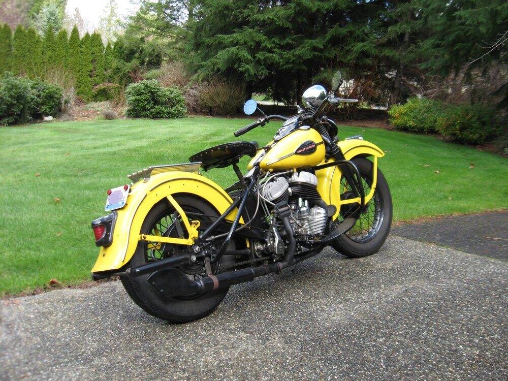

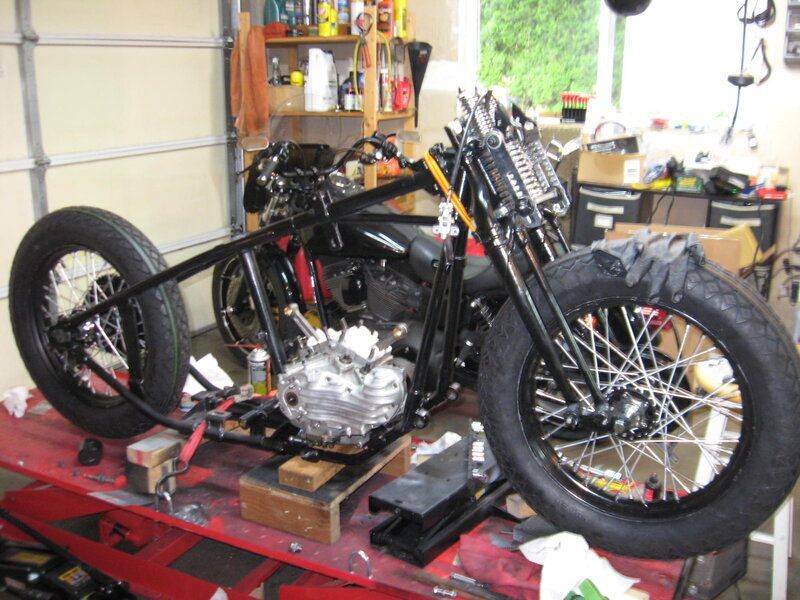

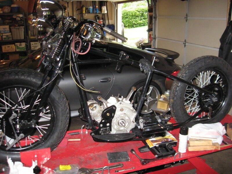

In the meantime, here's my '48. You can see the rocker clutch with its two pedals, and you can also see the shifter on the side of the tank. Once I get the '45 UL running I'll take this one apart and refresh the engine and transmission.
My '46 WL, which I just sold. The '45 UL of this thread will look a lot like this one, but with a 74 cu. in. engine instead of 45 cu. in., and with a 4-speed trans instead of a 3-speed.

I've been working on this bike daily, but not anything interesting enough to show in pictures. When I get the transmission back together and in place, I'll post some more pictures. And when we get the engine bottom end buttoned up, I'll post some of that, as well.

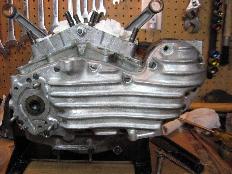

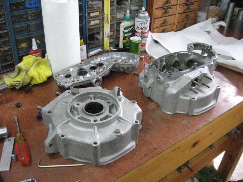

By popular demand (i.e., @Averagesupernova), here are a couple pix of the "guts."
Bottom left: left engine case
Bottom right: right engine case, showing the empty cam chest. This engine has four cams, one for each valve.
Rear: cam chest cover
My machinist friend is fitting new races into the case halves and is working on truing the flywheels in preparation for installing the flywheel assembly into the cases.
Most of the transmission, with the case on the left. The stack of gears to the right is the countershaft. The mainshaft is elsewhere but some of its gears are shown here and there. The transmission is a four-speed with what is called a jockey top (not shown). The gear shift is on the left side of the tank (you shift with your hand, not your foot -- the clutch is operated by a foot pedal).

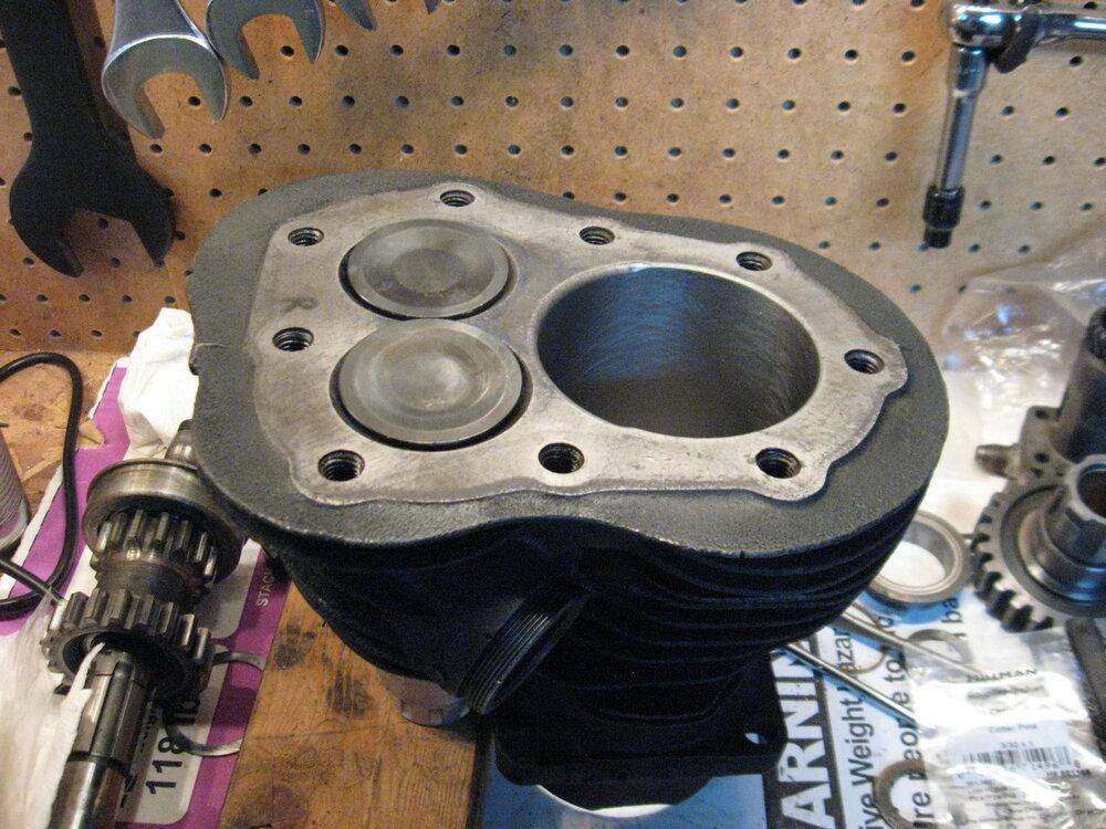

Some of you might not ever have seen a flathead (AKA sidevalve) engine, so I've included a couple pictures. The valves are lapped and installed, and the valve covers are in place.
Here's a pic of the top of the rear cylinder. The front cylinder is more-or-less the mirror image of the rear cylinder. The intake port is at the bottom of the image, and the exhaust part is on the back side, out of view. After the cylinders are installed, the heads will go on. The heads are just chunks of aluminum, with no moving parts. The terminology "sidevalve" arose because the valves are to the side of the combustion chamber, as opposed to being above it, as in overhead valve (OHV) engines. Flatheads are very low-tech.
This pic shows the exhaust port and the valve covers, the shiny tubes. The lower parts of the valve covers will be screwed into the tappet blocks that are attached to the right-side engine case. These valve covers are new and are cadmium plated.

Are you putting the same pistons in?
Any wear in the cylinders?
It looks like you honed them already.
what's the wear in time for these engines?
The cylinders showed some wear, but still had a lot of meat on them. The old pistons weren't worth saving, so they are new and .030" oversize. The cylinders were honed to accept the new pistons, with a bit of extra room to allow for expansion. The guy that worked on the cylinders said that they were a very hard ductile iron, and said he had to spend an entire day working on them.

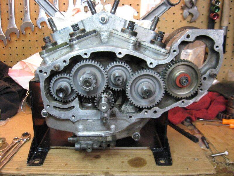

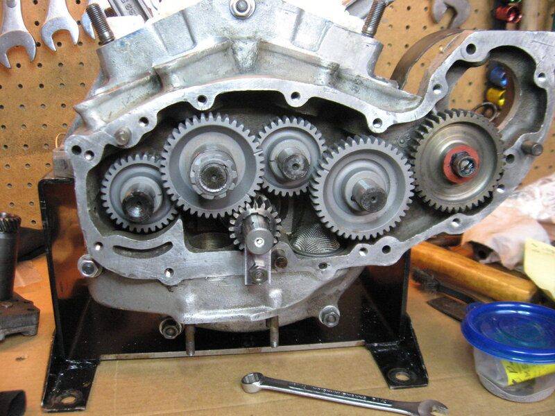

Things are moving along with the bottom end nearly complete. Here's a pic of the cam chest with its four cams, which are behind the cam gears (the four gray ones to the left). The cams and gears have to be installed in a certain position relative to each other and to the pinion gear, the small gear below the four cam gears.
---------------Rear exh. ------------Rear intake --------- Front intake ---Front exh.-----
Here's a shot of the right side of the engine, with the cam chest cover in place. It's not on for good just yet -- I'm checking the endplay on the cam gears, which can be adjusted by adding or removing shims.
Here's how the engine looks at the moment. The scavenge pump (at bottom of case) is installed and correctly timed. Its main function is to return oil from the engine sump back to the oil tank, but it also serves to let air in and out of the crankcase as the pistons go up and down. For this latter reason, it has to be installed with its gear drive in the proper relation to the pinion gear.
The tappet blocks and tappets are installed. They are just above the upper curve of the cam chest. The tappets ride on the cams, causing the intake and exhaust valves to open and close. When the generator is installed (it goes in the hole at the right, I can button up the cam chest, and install the motor in the bike frame. Then I'll be able to install the cylinders and pistons and heads, and put on the intake manifold and carb.
Tappet ---------Tappet -------------------------Tappet ---------Tappet

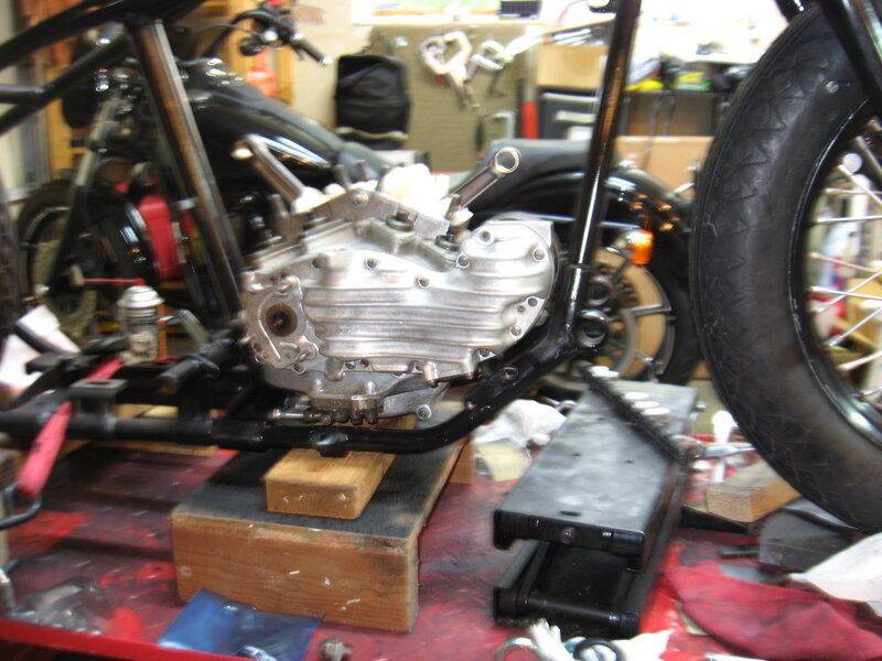

Back on-topic, I've hit a small snag. After I set the engine crankcase in the frame, I was all set to bolt it in, and start installing the generator, pistons, cylinders and heads, and intake manifold and carb. As it turned out, the engine mounts didn't align with the frame mounting holes. With the help of my machinist friend, we determined that the frame is a bit tweaked, so I've dropped the frame off with a guy who specializes in straightening motorcycle frames, and has been doing this for many years. Fortunately for me, the guy's shop isn't too far away, about 60 miles. There aren't many who do this kind of work, so he gets frames sent to him from as far away as the East Coast of the US.
In the meantime I can finish putting the transmission back together, after replacing all the worn parts. I'm hoping the frame guy will be done with it in a week or two.
