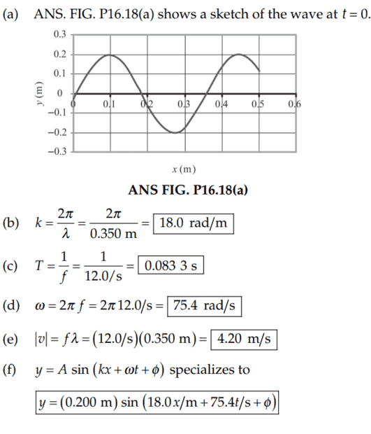

For part(a) of this problem,
Text problem: a sinusoidal wave travelling in the negative x direction with amplitude 20.0 cm, wavelength 35.0 cm and frequency 12.0 Hz, asking for the wave function and parts (a) to (g).
The solution is,

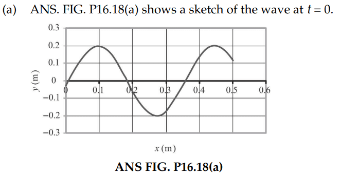

Graph of y in metres against x in metres showing a sinusoidal wave at t = 0, with y ranging from -0.3 to 0.3 and x from 0 to 0.6, peaking at 0.2 near x = 0.1 and troughing at -0.2 near x = 0.3.

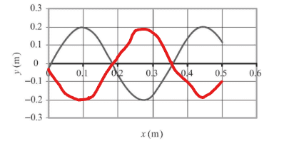

I don't understand why they assume on the graph where that the waveform is during it's phase. For example, could it not also be correctly drawn as shown in red:
Graph of y (m) against x (m) showing a grey sinusoidal curve with peaks near 0.1 m and 0.45 m, and a red curve of a different shape overlaid on the same axes, with y ranging from -0.3 to 0.3 m and x from 0 to 0.6 m.
Could it not?

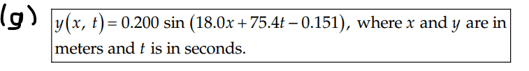

  • Equation y(x, t) = 0.200 sin(18.0x + 75.4t - 0.151), where x and y are in meters and t is in seconds.
  • Boxed equation labelled (g): y(x, t) = 0.200 sin (18.0x + 75.4t - 0.151), where x and y are in meters and t is in seconds.

Not an expert on the subject, but you might want to reread the second sentence of the problem, again.
"... travelling in the negative x direction..." & "...the element has a positive velocity here."
What exactly do you think those mean in terms of y(0)?

OK let's consider a more concrete example. Imagine a surface wave in the middle of the ocean. You see a wave maximum moving from right to left. At a place you call "0" you drop a basketball. How does it move as the wave goes by.

The point has a positive velocity. Will it’s value be larger, smaller or the same at the next instant in time?

OK, so let's put some giant graph paper in the ocean. The vertical motion can be in the y direction, the direction of wave travel (perpendicular to the wave peaks) can be in the -x direction, because they said the wave moves that way. Now reconsider those two functions you drew. Which best matches what the basketball does?

To expand a bit on what others have said:
Remember the motion of an element at a particular x-position is purely transverse.
https://www.physicsforums.com/attachments/1675801695226-png.321914/
You are told that when at t=0. the element at x=0 has a positive (‘upwards’) velocity.
And you are told the waveform moves left.
Ask yourself (or sketch) where the red and black waveforms will be a short time later.
You should then see why the red waveform isn't correct but the black one is.

Is the wave higher or lower at the next instant in time?
