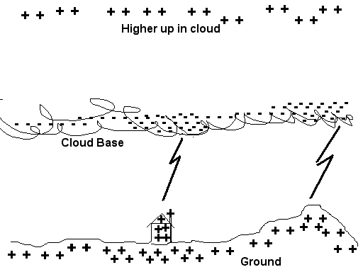

Dont confuse rain static (a build up of charge on an antenna) with a lightning discharge
2 very different beasties. Yes a charge built up from rain will be grounded with that grounding cable. But that's NOT going to stop the possibilities of a lightning strike. The charges building up between the cloud base and the ground below it are many orders of magnitude larger. The ground and higher objects, regardless of if they are metallic or not will build up a charge during the storm at an opposite polarity to the charge on the base of the cloud and regardless of if there is rain in that area or not.
There is going to be a higher build up of charge in areas where the ground or anything on it, and the cloud base is closer together. In the absense of highpoints over relatively flat ground, where the lightning strikes will be somewhat more random.
Note in the drawing, the displayed positions + and - charges can be reversed depending on what is happening within the different parts of the storm.
A couple of times during my storm chasing, I have been able to video ground to cloud strikes.
Dave
No form of grounding cable to Earth rods is going to protect your property from a direct strike. The voltages and currents involved are just so huge. Your antenna mast pole coax and grounding cable will all most likely end up being molten blobs of metal.
In a former life (read... previous job) I did installations of antenna on comms towers, wooden and steel lattice. We would go to extrodinary lengths to try and mitigate lightning strikes 2.5 - 5cm diameter 2 metre long galvanised tubes bolted to the top of the structure , above all the antennas The grounding straps from the tubes to the ground were 2.5 cm wide .5cm thick copper bands which would be connected to large Earth mats buried in the ground around the mast.
Even with all that we would still get comms equip totally fried and blown to bits.
We deemed all that protection only really valid for close by strikes.
Look at it this way... what thickness of copper cable are you going to use for your grounding lead from the mast to the Earth rod ? 3-4mm diameter ?
it will be as effective as a 1 amp fuse in a 200 amp cct :)
it all boils down to if you have a direct strike, the best protection is a VERY good insurance policy :)
Dave
