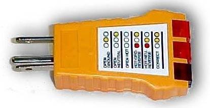

What country are you in? Can you post a picture of this power supply and it's safety agency approval label?
You said in your OP that the power supply has a 2-prong power plug, but in this post you talk about a "ground pin". What ground pin? On the 2-prong plug, or in the wall socket?
And you are saying that the wall outlet has that large voltage between the Neutral pin and Ground pin? In the US that would be a fault, and quite dangerous. Do you have access to a wall socket electrical tester like the one shown here?
http://www.liberty-hi-railers.com/images/outlet_tester.jpg
The wall socket voltages look normal. Ground to Neutral about 2VAC, Line to Neutral about 219VAC.

That outlet checker you pictured is only 5 bucks at my local Wal-Mart. No household should be without at least one.
I'd wager somebody didn't connect the "ground" wire immediately behind his receptacle.
If the receptacles in his house are "daisy chained, several of them may be open.
