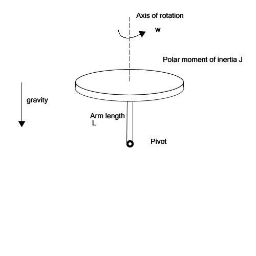

I've been a little confused - I'm currently designing a rotorcraft but I need to be able to predict the force (or torque) I'd need to tilt the rotor.
What I've done is model the rotor as a simple rigid disc. I've attached the diagram below. what sort of behavior would I get during trying to tilt it in any direction? Please note that the pivot is a ball-socket joint and so it's able to tilt in any direction.

Have a look at the moment of gyration; http://en.wikipedia.org/wiki/Radius_of_gyration
The amount of force required to tilt the rotor will be based on its moment of inertia and angular velocity.

That link simply tells me how to calculate the radius of gyration. Nothing about moments.
What I'm working on is a gyroplane - hence the requirement for tilting.
