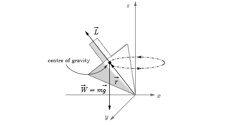

Hi there!
I've been searching the internet for hours trying to find a decent explanation to this question.
I'm thinking particularly of the example of a precessing spinning top.
Diagram of a spinning top tilted about a fixed point, with axes x, y and z, a vector L along the spin axis, a dashed precession arrow around the z axis, weight W = mg acting downward, and vector r from the contact point to the centre of gravity.
(Note: I own this diagram. Please do not use it without direct and written permission.)
So when the top is tilted away from the axis of symmetry, its weight W and the reaction force produce a couple set apart by the distance r from the point of contact and the centre of mass/gravity. The best explanation I've found is that the torque T produced by this couple produces precession, wherein
T = r × W
However this does not seem to explain where the centripetal force occurs because - according to the vectorial product - this torque acts in the direction of angular velocity, not perpendicular to it! In the above diagram the torque would be pointing towards the viewer from the centre of gravity, right?
Thanks in advance,
Harry
Yes, that is correct.
In the diagram above the angular velocity is almost entirely in the direction of L, which is perpendicular to the torque. The small angular velocity in the z direction is deliberately neglected.

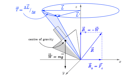

I've again updated my diagram to reflect this.
Vector diagram of a spinning gyroscope precessing: weight W = mg acts down through the centre of gravity, reaction R splits into Rz = -W upward and Rx = Fc horizontal, and a horizontal change in angular momentum ΔL forms the torque T.
(Please do not use diagram without direct and written permission.)
Thank you so much for your help, Dale!
Harry

Sounds like you got it. Glad to help.
The only thing that I would correct is that on the diagram L goes along the axis of the gyroscope. So diagonally up and to the left in the diagram, not horizontally to the left.
Ah yes! I've recified it in the final diagram to show L - Lz and L' - Lz (so the L vector is acting in only the x-y plane). This way ΔL = (L' - Lz) - (L - Lz) = L' - L.
Thank you again!
