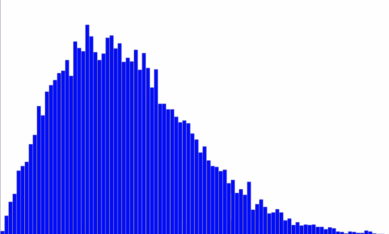

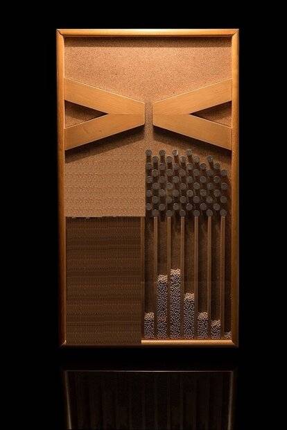

Hello.
Is there a name for distribution that describes "broken" Galton box like this?
And distribution formula..
Edit:
I've also attached how it looks like in simulation.
Thanks.

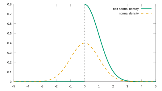

zasvitim said:
Hello.
Thanks.
Yes, skip the "of": half-normal distribution.
I guess, your example of the halved Galton Board is better described by the truncated normal distribution.

zasvitim said:
No, it actually looks different - like this:
You mean a bit like this:
I can only see that the parameters differ.
It's value grows from 0 as particle can not get there - gets out. It's definitely different behaviour.
