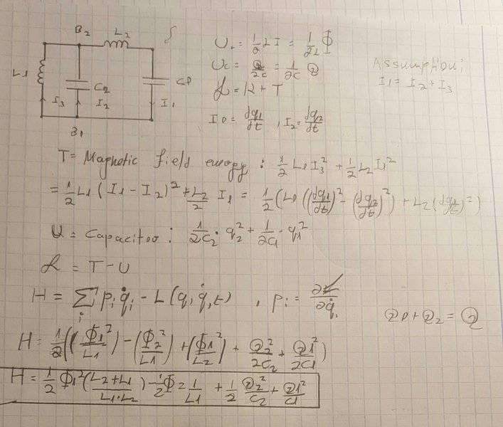

What is the Hamiltonian for an LC circuit?

Hi i got a problem in lc circuit, I need to find the hamiltonian to this circuit , I think that I did well but I am not sure, the problem and my attempt in the following file.

The Hamiltonian is simply
$$H=T+U$$
You don't need to find the Langrangian first.
