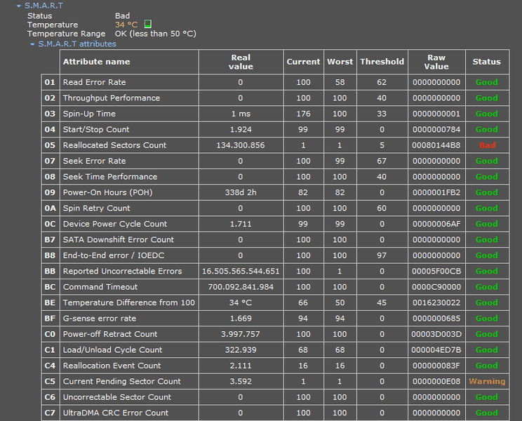

What is the situation for my hard drive now? Can I fix it with a software? Should I change it? The PC is working with no problem? What should I do now? Should I change the hard drive in the service? S.M.A.R.T status is bad. There was nothing a few days ago. I cannot understand how this has happened

Do you not believe the diagnostic when it says the drive is bad?
Make a backup if you can of whatever you can meaning backup your files first not the whole disk.
Drives are mechanical so there's room for motor failure, actuator arm failure, flying head failures which can scratch the disk, plate warpage from heat ...

I still do not understand what is the problem. What is broken? Do you mean by diagnostic that program I have pasted here the pic of it? If so, yes I believe the program but I have checked the hard drive with that program a few days ago. There was nothing wrong. I mean this.

If you trust the program, and the program says the drive is bad, what is your question?

It says "Status Bad". That means the drive is bad and needs to be replaced.

Reallocated Sectors Count indicates the count of reallocated sectors. When a drive finds a read/write/verification error it marks the sector as "reallocated" and transfers data to another part of the drive. This is why, on a modern hard disks, you will not see bad blocks while testing the surface - all bad blocks are hidden in reallocated sectors. The more sectors that are reallocated, the worse your drive gets, you'll see your drive working slower and slower.
The way you read smart tests is that your current values need to be above the threshold.
In this case, your current is 1 and your threshold is 5. Your drive is dying and could fail any moment. Different drive vendors report the numbers differently so the raw/real values can mean anything. If you want to know wha that the actual count of reallocation events is, then you'll need to find the documentation for your specific drive and learn what the raw/real mean.
This can happen due to age, normal wear&tear, bad luck, or you my gave unfortunately received a potato that looks like a HDD instead of an actual HDD (a bad hard drive).
That is extremely unlikely,
although there is software which attempts to figure out the status of physically failing sectors and relocate them.
What you really need to to do is backup anything important on that disk then replace the disk.
Before you then throw it in the trash though, you could do a full reformat on it.
If it's just a bad track or two, and not head failure, it may be good as a secondary storage for a year or two.
No, the problem cannot spread to other drives, it is a physical failure of some sort.
