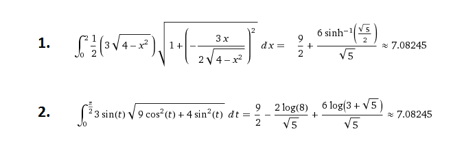

How to integrate:
I used formula: sin^2(t) = ( 1-cos^2(t))
and now it's:
Then:
u=cos(t)
du=-sin(t)
What to do next?
We may now rewrite the integrand as:
[tex]-6\sqrt{s^{2}+1}, s=\frac{\sqrt{5}u}{2}[/tex]
Now, utilize the trigonometric identity:
[tex]\tan^{2}(y)+1=\frac{1}{\cos^{2}(y)}[/tex]
in a creative way.

Actually the task sounds like this:
Maybe I have to use polar coordinates? Any sugestions? Before I tried with diferent way, but I guess that integration without polar coordinates is too hard.
L is a segment of an ellipse. You might go polar, but you can eliminate t as well, and express y as a function of x(Hint: sin^+cos^2=1)
Seems to me that variant when we use y=y(x) is more complicated than variant with polar coordinates.
in a creative way.
Not clear, how did you get there: [tex]s=\frac{\sqrt{5}u}{2}[/tex]
We didn't learn about triple substitution, but I want to understand, how to get the final result. Can you explain some how?
