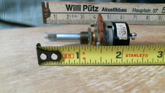

Planobilly
440
105
This is a on off switch for a McIntosh 2120 stereo power amp. It is a snap switch of sorts built in a potentiometer case with the switch attached. The shaft is 25mm. Due to the fact that it closes a relay I don't think it has much current running through it.
I just can not seem to find anything to replace it. Both Digi-Key and Mouser say they don't have anything like it.
Any ideas??
Cheers,
Billy

Thanks for the kind offer. The actuall switch part is working fine. It is the plastic arm in the pot case that failed. I have seen some pots with a switch for sale and even some that had more or less the correct shaft length but not the half shaft D shape ending. All these seem to be in the mili amp range and low voltage I want to use the original knob from the unit if that is possible. The good news is that the original knob can be modified to except a round shaft or split shaft.There is no way to mount a short shaft control on the amp as the face plate is some distance from the mounting surface. What one gets into messing around with old electronics...lol
I even took the old switch apart and super glued the plastic part that failed back together but I don't think it will last very long. If push comes to shove I can machine a new part and repair the old switch. I have a small four axis CNC mill. That would require a good bit of work. I don't have a 3D printer, which would be ideal to make a new part with.
I guess I expected there would be a simple rotary on off switch in common shaft lengths to be had. There are many but not any I have found that will fit.

ALPS (the switch mfg. shown in your photo) is still in business and their catalog can be found at: http://www.alps.com/products/e/pdfcatalog_list.html
BTW that shaft style is called 'half flat' and it looks to be 0.250 in. diameter, which would make it '1/4 in., half flat, 1-3/8 long'. Shaft length is measured from the the device mounting surface, i.e. the shoulder on the threaded bushing that is against the inside of the chassis when mounted.
Clarostat brand used to make a bunch of 'mix-n-match' pots and switches for the electronic repair industry. A Google search for 'Clarostat pots' returns >50 000 hits. Clarostat was bought out by Honeywell and their parts aren't widely distributed these days. The shafts an these are aluminum these days and the very old originals had brass shafts. Some imports have plastic shafts. So a file and hacksaw can readily reshape them if the shaft is long enough. There used to be, and maybe still are, 'shaft extensions' available. They slip onto the switch shaft, are held on with a set screw and have a standard shaft on the distal end.

Mouser claims to have 26 of this in stock
it has a 1.5 inch shaft with a flat on it, dimension on datasheet
http://www.mouser.com/ProductDetail/CK-Components/A10215RNZQ/?qs=sGAEpiMZZMvNbjZ2WlReYkMRQ%252b%252bBkxIQBjHdF6Jb1WM%3d

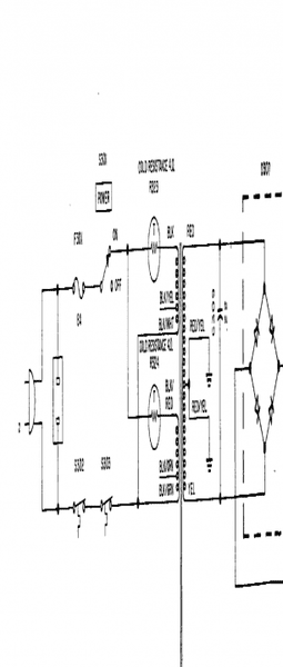

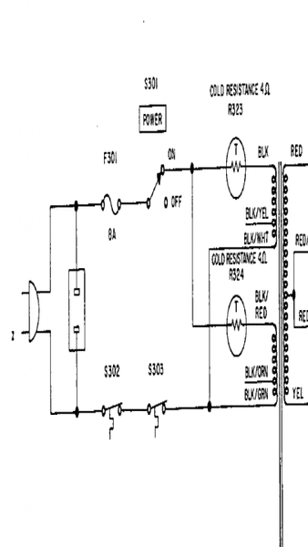

Here is the schematic.
Bill
Bill
Well, that's sure enough just a switch. Thermistors are there to prevent destructive inrush current but i can't read their cold resistance value..
I'd think that switch would be okay - datasheet says it's rated 5 amps continuous carry.
Silver is good contact material for substantial current
and the filter caps that i assume are downstream of bridge will snub inductive kick from the transformer so you don't need tungsten arc-proof contacts.
Sort of what I thought Jim. There is nothing special about the switch. Cold resistance is 4 ohms.

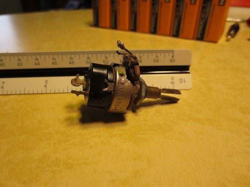

This might be a tad late to help you, but I encountered the exact same problem on a different McIntosh amplifier, an MC2205. It took me quite some time to come up with a "fix", but it is a robust fix for my broken switches; ALPS 146-183. Take a look at the attachments. Note, like many one-of-a-kind engineering projects this one is still being "tweaked". The repair steps write up shows the first successful new part, but since then I developed an easier to print part, version V8. If you'd like to try this fix, you'll need the .stl (stereolithography) files for the 3D printer, or you'll need the original 3D design files, created using Designspark Mechanical (a free 3D mechanical design tool). send me an email I will forward them to you.
