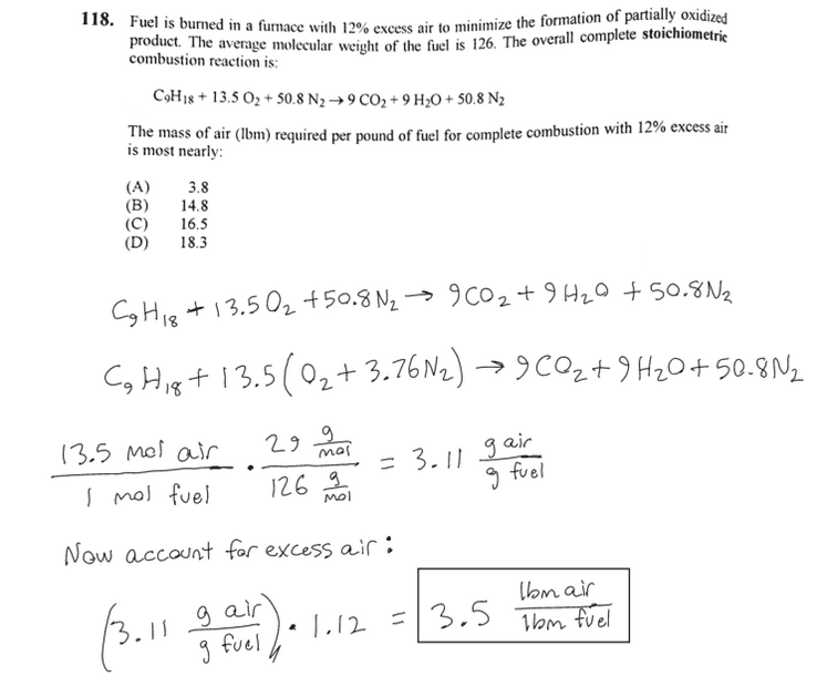

Fuel is burned in a furnace with 12% excess air to minimize the formation of partially oxidized product. The average molecular weight of the fuel is 126. The overall complete stoichiometric combustion reaction is:
C_9H_18 + 13.5 O_2 +50.8 N_2 ---> 9CO_2 +9H_2O + 50.8N_2
I'm surprised that I'm getting this wrong. Seems like everything checks out in my calculation. Correct answer is supposedly C.
Your mistake is in saying you have 13.5 moles of air. 1 mole of air is 0.2 mol O2 + 0.8 mol N2. Actually you have 13.5 moles O2 and the stoichiometric amount of N2.
Makes sense. Thanks.
