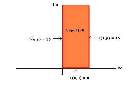

The plane region defined by [tex]\[A = \left\{ {(x,y)/0 < x < 1,0 < y < \infty } \right\}\][/tex] defines the profile of a semi infinite wall, where there's a stationary regime heat flow. The left and right sides are isolated at 15º, and the base is isolated at 0º. Find T(x,y) in each point of the wall.
Two-dimensional Heat equation: [tex]\[\frac{{{\partial ^2}T}}{{\partial {x^2}}} + \frac{{{\partial ^2}T}}{{\partial {y^2}}} = \frac{{\partial T}}{{\partial t}}\][/tex]
Diagram of a rectangular region in the complex plane with Re and Im axes, shaded orange, labelled Lap(T)=0. Left and right sides marked T(0,y)=15 and T(1,y)=15, base marked T(x,0)=0.
This problem got me thinking, because it's done either one of two ways: either I treat it as a problem of separate variables and use Fourier Series, or I treat it as a differential geometry problem (Dirichlet problem, since in stationary regime the heat equation becomes Laplace's equation). I tried thinking of it as a Dirichlet problem.
If I treat it as a differential geometry problem, I have to use conform transformations. First I have to multiply the whole thing by [tex]\[\pi \][/tex], so that then the wall has its sides at x = 0 and x = [tex]\[\pi \][/tex] (the base remains at y = 0, and it remains semi infinite). Then I have to traslate it [tex]\[ - \frac{\pi }{2}\][/tex], so that now the sides are at x = [tex]\[ - \frac{\pi }{2}\][/tex] and x = [tex]\[\frac{\pi }{2}\][/tex].
So far, I transformed [tex]\[x + iy\][/tex] into [tex]\[\left( {\frac{\pi }{2}x - \frac{\pi }{2}} \right) + i\frac{\pi }{2}y\][/tex]. Now, I've only seen this kind of problem in which there are 3 contour conditions being solved by applying the transform sin(z). If I do that, then I transform the strip into Im(z) > 0, now I have transformed [tex]\[x + iy\][/tex] into [tex]\[\sin \left( {\frac{\pi }{2}x - \frac{\pi }{2}} \right)\cosh \left( {\frac{\pi }{2}y} \right) + i\cos \left( {\frac{\pi }{2}x - \frac{\pi }{2}} \right)\sinh \left( {\frac{\pi }{2}y} \right)\][/tex].

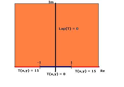

The image is then transformed into:
Diagram of a rectangular region with Im on the vertical axis and Re on the horizontal axis; the bottom edge is red except a blue segment from -1 to 1, labelled T(x,y) = 15 on the red parts and T(x,y) = 0 on the blue segment; a black vertical line at Re = 0 is labelled Lap(T) = 0.
Now, using polar coordinates, T doesn't depend of the radius, [tex]\rho \[/tex], so [tex]\[{\nabla ^2}T = \frac{1}{\rho }\frac{{{\partial ^2}T}}{{\partial {\varphi ^2}}}\][/tex]. This means that [tex]\[T(x,y) = A\theta + B\][/tex].
But I can't go pass that. I don't know how to find A and B using the countour conditions.
Any ideas?
