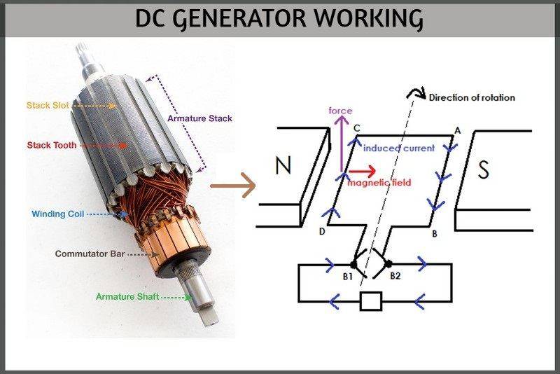

…the stirling engine operates at 32% efficiency… for every 4 kilowatt hours of heat supplied, 1.28 kilowatt hours of mechanical energy is generated. the mechanical output of the stirling engine is attached to a generator…
the generator operates at 95% efficiency… for every 1.28 kilowatt hours of mechanical energy supplied, 1.21 kilowatt hours of electrical power is produced. the electrical power is used to charge a battery…

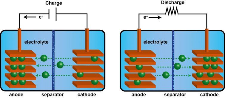

… the battery charges at 95% efficiency… for every 1.21 kilowatt hours supplied, 1.15 kilowatt hours of energy is stored. 1.15 kilowatt hours of stored electricity has been produced from 1 kilowatt hour of electricity input. the extra energy obtained came from the heat energy of the surroundings which have now decreased in temperature as a result of the process.
