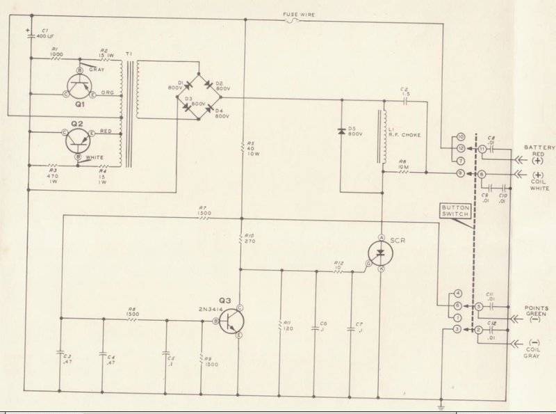

One of my transistor has failed I tried replacing but sticking any transistor in there does not seem to work. Someone from that worked for Heathkit told just look up number this would work except I can not find cross for 230-616. When this unit worked it always put a little wine out I think it was from the transistors but not sure. Need to know more info like base to collector voltage and power rating.

Can't see your whole schematic.
Hopefully there's nothing too special about those transistors. Only potential trouble spot i see is Vbe rating .
do those two transistors get power from 12 volts ? Probably.
A circuit like that is usually not too choosy about transistor parameters, it self-oscillates by positive feedback so it'll tolerate quite a bit of slop.
The transformer's time to saturate determines frequency.
The transistors are just switches. When one of them turns on, positive feedback via tapped transformer winding reinforces its base drive. Same feedback in other half of winding opposes the second transistor's base drive turning it hard off.
That condition persists until the transformer saturates which removes 'base boost' from the transistor that's conducting and removes 'base holdoff' from the other, so the transistors swap states.

I can't make out values
maybe @John1397 could use Paint to annotate part of his drawing
a 15 and a 430 would bias a germanium barely into conduction, 0.40 volts
a 25 and a 430 would bias a silicon barely into conduction, 0.66 volts
to assure it'll self start.

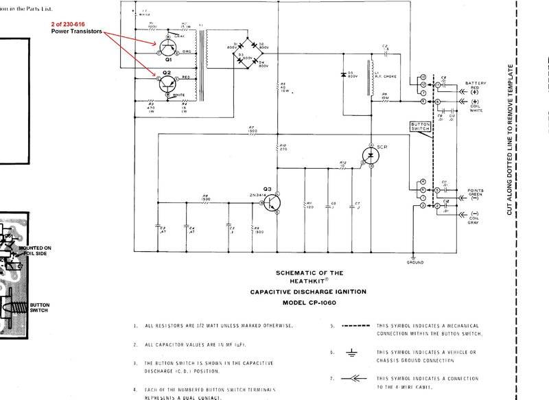

Excerpted from a CP-1060 manual posted to radiomuseum.org.
15Ω, 1 watt resistors for b-e on both transistors. Q1 has 1KΩ from c-b while Q2 uses 470Ω. Donnerwetter! ... Germanium is looking more and more likely.
Yep. Looks like Q2 gets to do the kickstart.

RE tickler winding voltage :
1 watt in 15 ohms would be about ¼ amp
well within 1N5913's 454 ma current capability
looks to me like shunt EB protection by zener just might just work okay.
that is if he wants to change to silicon.
Caveat - Some trial and error may be required to arrive at biasing resistor values because things seldom go as easy as they look like they should. We all know Murphy was an incurable optimist.

The R1-R2 and R3-R4 voltage dividers don't make enough voltage to turn on a silicon transistor.
You'll have to adjust the bias resistors to get about 3/4 volt drop across the 15 ohm ..
If your 3791 is Q2 try tacking 250 to 300 ohms in parallel with R3.
If your 3791 is Q1 try 200 to 250 in parallel with R1.
Place a 1N4001 between base and emitter of your 3791, cathode to emitter and anode to base.

2N456A crosses to an NTE104 (still available from various vendors at about $25 a pop). I haven't bought anything from them in decades so can't say how they are now, but http://www.bgmicro.com/pnp-germanium-house-number-to-3-like-2n176-2n256-2n555-nte104-and-nte121.aspx claims to have equivalent parts for $1.56/each; cheap enough to cause no heart break if they don't work out.
