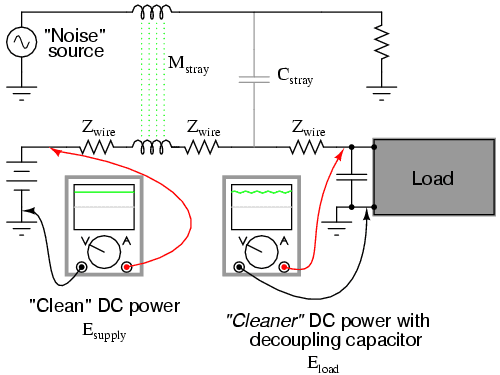

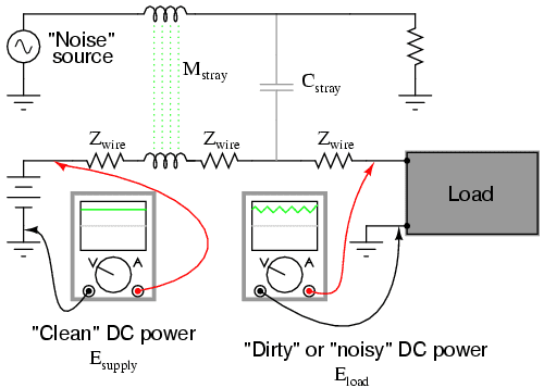

reading this: http://www.allaboutcircuits.com/vol_2/chpt_8/2.html
and this: http://linuxcar.sone.jp/reg.en.html
and this: http://www.play-hookey.com/ac_theory/ps_filters.html

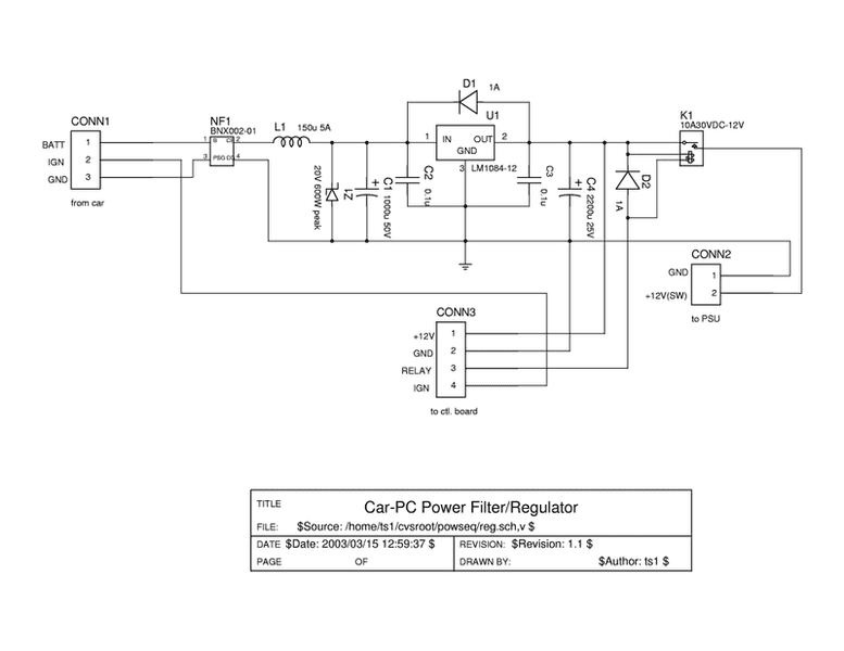

I am borrowing a spare of the offending units, an MSD 6AL, to bench test with. It is rated at 1 amp draw per 1,000 RPM. I will hand-turn a spare distributor to fire off the ignition, running off a small 12V gelcel, to replicate the issue. I can then use a drill to gain speed. The issue shows up at a measly 500 RPM, which is only 250 RPM of the distributor, or about 4 rotations per second.
Things I see on the second to last image: 150uH inductor, 20V 600W Zener (is that really necessary?), 1000uF decoupling cap before regulator, 2200 decoupling cap after regulator.
seeing as 1470uF brought it down to 20Hz, The next step of 2000+uF and an inductor is all I need?

I have the filter configured as a pi filter, 3900 uF input, 470uH inductance, 3500uF output.
