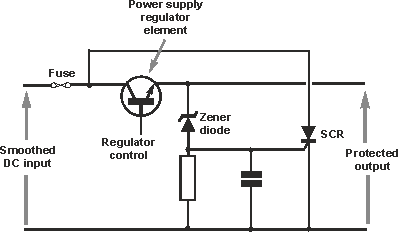

Thanks all for your replies. I had a look at this:
Suggested mods: Because the power supply has a current limit, there would be no need (I guess) to try to blow a fuse, so the anode of the SCR could just be connected to the positive rail directly above it. The cap is to prevent tripping for brief transients, which I want, so could be omitted.
However, both this circuit and the TVS seem best suited to clipping ‘forward’ transients FROM the power supply. The transients that killed the IC were presumably retrograde and reverse voltage (coil flyback). Would the crowbar or TVS set-ups clip these?
I was thinking MOV for its bidirectional action, as well as simplicity and cheapness. Your thoughts would be welcomed, however.

I would be a little careful the way you hook an SCR to the output. Go with what another company has done. Astron has been building reliable power supplies for years. There are many places on the web that their schematics are posted. You need a certain amount of capacitance in order to prevent nuisance firing of the SCR. Also, be careful that the SCR is protected from overcurrent on the gate. The SCR is not infinitely fast, so have some current limit on the gate.

The TVS (MOV) would, so would a simple diode (rated at a few amps) connected reverse polarity across the output. You are right about a crowbar, it would not protect against reverse polarity spikes.

So you want to blow your input fuse any time there is a transient on your PS output? I understand that you are frustrated at having to replace the opamp IC, but going for a protection strategy that blows the fuse instead or just absorbing the transient in a protection circuit doesn't seem wise to me...

The supply has a current limit, so a crowbar would just activate that.
Putting all the above comments together, it seems that the damage is caused by a significant reverse polarity voltage entering the supply, getting thru the voltage sense circuitry, and destroying the op-amp. An active crowbar, as I first suggested, will not necessarily prevent this.
The reverse voltage must be either blocked or clamped before it gets into any active circuitry. Blocking could consist of a series diode at the output terminals, but this partially defeats the voltage regulation due to the diode voltage drop.
Clamping would be something across the output then effectively shorts any reverse voltage. This clamping could be a reverse-biased diode or a surge suppressor (TVS or MOV). A MOV is bi-directional and also will not conduct until the threshold voltage is reached in either polarity, fine for over-voltage, but will not clamp a reverse voltage until the threshold voltage is reached.
Therefore, I believe a reverse polarity diode across the output is the best solution for your present problem. A crowbar is fine for overvoltage clamping, but that is a separate problem that you don't seem to have (so far).
Not the way your schematic is drawn. The crowbar is connected to the Input to the power supply, just after the fuse.
