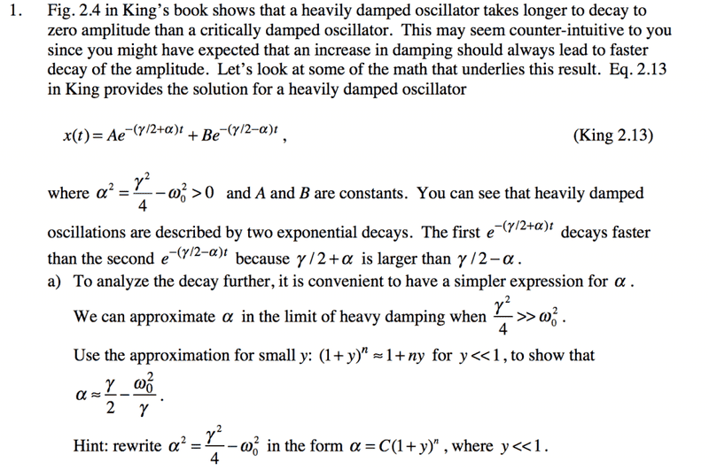

I'm not really sure how to go about this.
They tell me the hint, and to use the simplification. I assume when they say (1+y)^n they take y to be in general, anything. It was confusing at first to see a y in the format when no y was present in any of the previous equations.
So, we know ϒ^2/4 >> w_0^2
So, could we say α^2 = ϒ^2/4 -w_0^2 can turn into α^2 = ϒ^2/4 => α = ϒ/2.
But this is not of the form α = C(1+y)^n.
So, we know ϒ = b/m, but that doesn't seem to help too much as α = b/2m is still not in that form.
Any hints on how I can start this off on the right way? I have a lot of equations in front of me and I feel with a good start up hint ill be off to the races.
Read the given hint. It is there for a reason. You have only kept the leading term and not the first order correction.
α^2=(ϒ^2/4)-w_0^2 and we want it in the form α = C(1+y)^n
I'm not quite sure what you mean with this quote.
The only way I can think of it is if we immediately take a square root of both sides.
α = sqrt(ϒ^2/4-w_0^2)
This is somewhat like what the hint desires, but I feel like I won't get anywhere with this (As I've tried some calculations with this).
Rewrite the square root as an exponent ...
Ah, so you are suggesting there is more here.
α = [ϒ^2/4-w_0^2]^(1/2)
In this case, C = 1
But, we need it to be in the form (1+y)^n
So, perhaps let's try to factor out a ϒ^2/4 from both terms
So we get
α = ϒ/2[1-4*w_0^2/ϒ^2]^(1/2)
Now it is appearing to be in correct form.
So,
α = ϒ/2[1-(1/2)*4*w_0^2/ϒ^2]
Simplifying we get
α = [ϒ/2-w_0^2/ϒ]Oh my god.
I just solved it.
I love math. I also love you.
Why oh why did this take me hours.
Maybe this particular type of series expansion is not fundamental in your research subject - it is in mine. :rolleyes:
