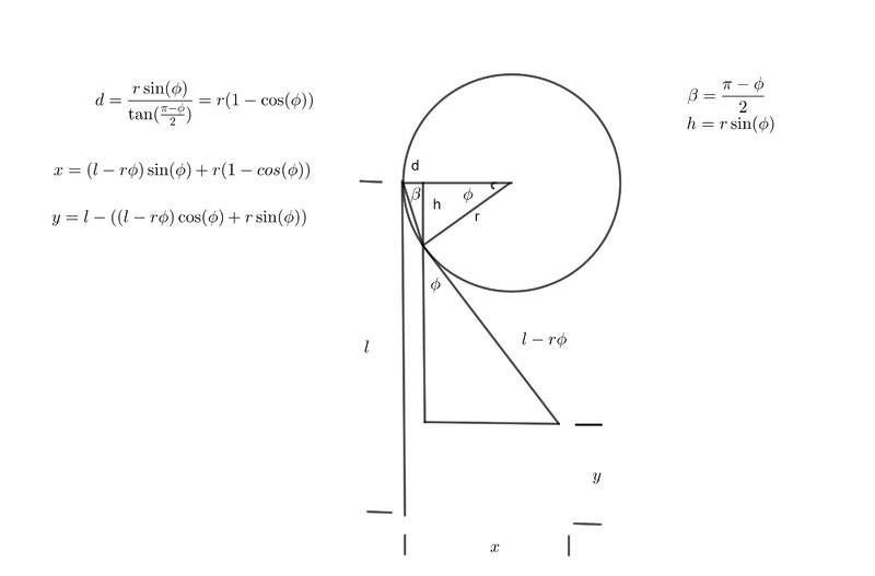

When the string comes in contact with the peg the subsystem arm is shortened by ##r\phi## where ##r## is the radius of the peg and ##\phi## is the angle measuring how much the string raps around the peg. This shortening of the subsystem arm causes it to increase in frequency. By conservation of energy the increasing frequency must be compensated by a decrease in amplitude.

You are absolutely right! I was guessing and when I guess I usually make myself the fool. I, however, determined to get to the bottom of this controversy, so I analyzed the subsystem using Lagrangian dynamics. I derived the geometry of the situation in this figure:
From this I came up with equation of motion for the subsystem:
\ddot \phi = \frac{2r\dot{ \phi}^2}{l-r\phi}-\frac{g\sin{\phi}}{l-r\phi}

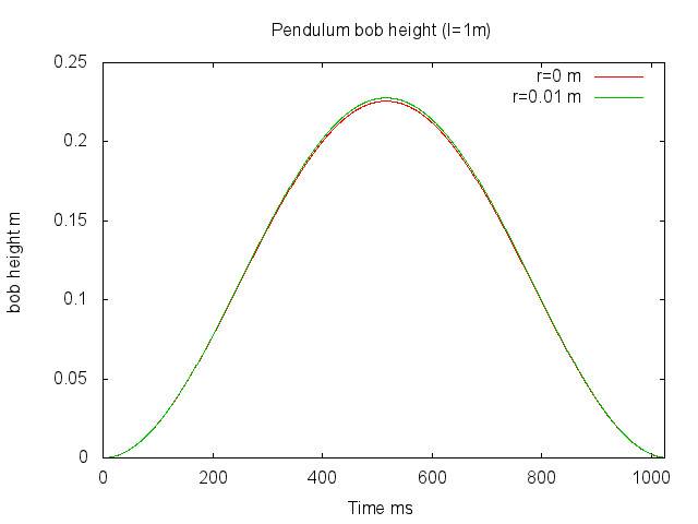

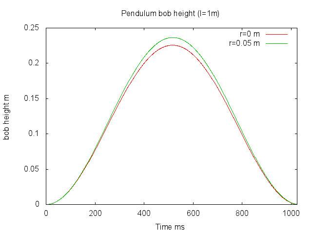

I wrote a C program to integrate this equation using the Runge-Kutta (RK4) algorithm (neglecting air resistance). The first plot below shows the height of the bob vs time with ##r=5cm## and ##l=1 m## compared to the height with ##r=0##.
The analysis shows that the height exceeds the ##r=0## condition. Below is a plot where ##r=1cm##.
Clearly, as the radius of the peg becomes smaller, the difference in height becomes negligible. I don't blame you for observing my analysis with a jaundiced eye, but wanted to get a handle on the situation and go beyond my silly guess.
