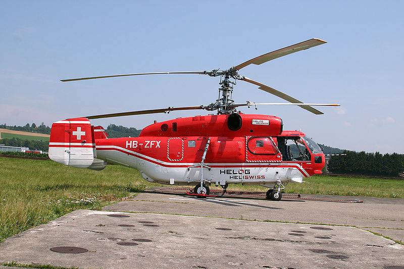

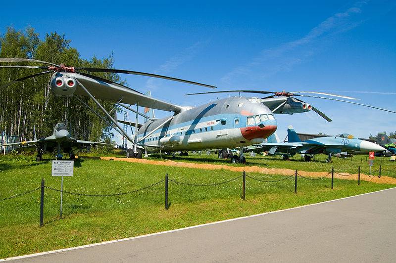

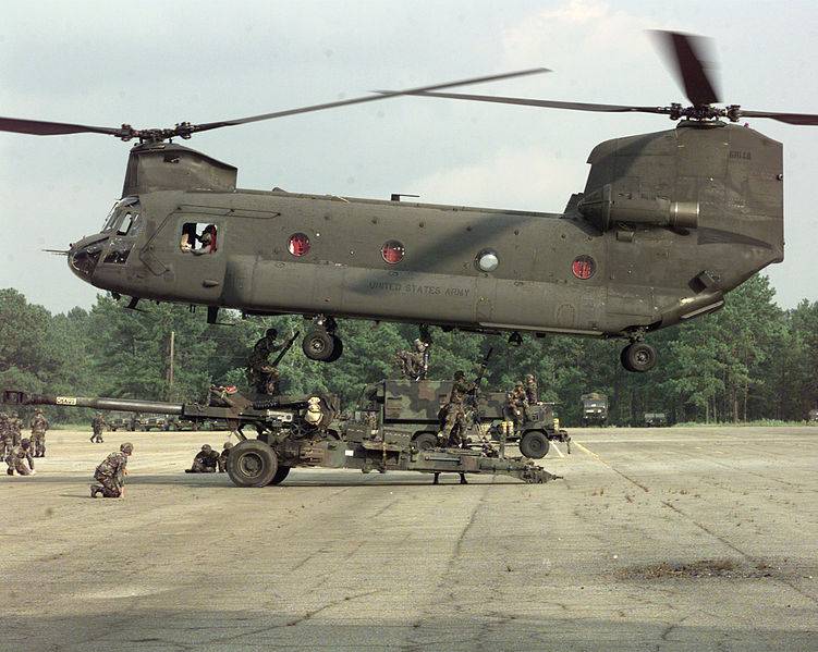

Great question. The answer is that without extra features, the helicopter does turn in the opposite direction. As rcgldr pointed out, a tail rotor pushing in the opposite direction can cancel out the torque. Another interesting approach is to have two main propellers rotating in opposite directions so that the torque cancels, and then you don't need a tail rotor. The two propellers can be side by side, inter-meshed, in tandem, or coaxial (notice no tail rotors):
