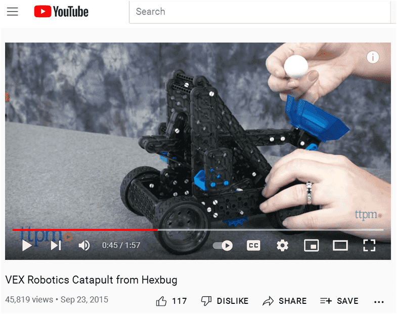

Welcome to PF, @Truffle98 :smile:
I don't think I'd use flywheels to lauch the ball -- it seems like it would be pretty hard to get consistent launch velocities and no sideways spin (due to friction and compression issues). Instead, I'd be thinking more along the lines of an adjustable catapult-type launcher. I'd probably make the forward stop point variable to change the launch angle, and the sping-loaded back point adjustable to be able to adjust the exit velocity from the catapult launcher...
