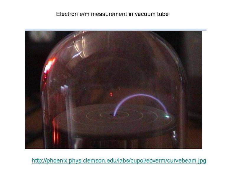

In one laboratory electron e/m measurement, the electrons are accelerated to the anode in a vacuum tube, and a few electrons pass through a hole in the center of the anode into a field-free region where the electrons drift at constant velocity in a transverse magnetic field. See attachment.
Bob S
Picture from http://phoenix.phys.clemson.edu/labs/cupol/eoverm/

I agree, Bob, that this is the standard way of doing the e/m calculation. However, the poster's description in the 1st post got me wondering if this was some other method. (One I'm not aware of). If so, as well as explaining my incredulity, it would also explain why, using the standard equations, the results are causing a problem.
