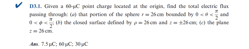

Hello Guys !
iam studing the electric flux and how the relationship between D ( electric flux density ) and E ( elecric field)
but i found this problem and i don't know which formula should i use to solve it to find the electric flux
i know that Q=(Psi)=the electric flux but i don't know how to use this to solve this problem
i tried to use the integration of the volume of the sphere which is r^2 sin(ceta)*dr*d(ceta)*d(phi)
but i didn't reach to the number in the solution ...I need your help !
You don't integrate over volume, you integrate over surface area.
hmmm , this means that i will integrate r^2 sin(ceta) *d(ceta)*d(phi) ??
You don't actually perform any integration. You use Gauss's theorem thruout.
