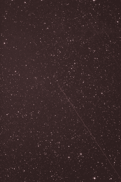

timmdeeg said:
TL;DR Summary: Question: What tumbling object causes this trajectory?
I have received this image from someone in Namibia recently at the Kiripotib Astrofarm.
Has anyone an idea what could cause such a strange trajectory?
Perhaps a cylindrical object that is reflective only on one end?

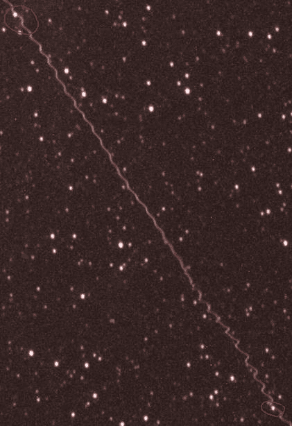

Sorry for being absent for some time.
This I have been thinking too, but the explanation seems much different after some discussion with a former astronomer at the university of Heidelberg.
There are two traces, a broad one like a snaky line and above a thin one which ist straight. Imagine a vibration of the mount (which I have never experienced myself though) and that both lines originate from satellites. But why then snaky and straight?
The duration for satellites to go through the image section is about seconds (remember 1000 mm focus length). Now two assumptions: First, the satellite above (straight line) went through after the satellite below. Second, the mount vibration was finished before the above satellite went through. Indeed the amplitude of the snaky line is decreasing at the lower side of the line, before passing through.
Why the broad line? It seems it can be shown that's due to a very rapid satellite motion/tumbling.
Please let me know in case above conclusions are not consistent.
This issue will be most probably be discussed in the magazine "Sterne und Weltraum". I'll keep you informed.

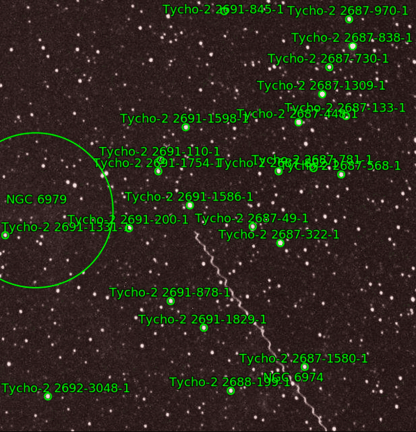

This is a crop from which I roughly calculate the amplitude of the curved line to be 15 arc s using the Astrometry.net data below. This shouldn't be a problem with Autoguiding.
Center (RA, Dec):(312.617, 31.896)
Center (RA, hms):20h 50m 28.049s
Center (Dec, dms):+31° 53' 45.233"
Size:18.8 x 19.5 arcmin
Radius:0.226 deg
Pixel scale:0.796 arcsec/pixel
Orientation:Up is 88.2 degrees E of N

timmdeeg said:
0.796 arcsec/pixel
Ps after you uploaded it here, the image size was scaled down to 1.9 arc seconds per pixel.
Pixel scale:1.9 arcsec/pixel
  • #53
Devin-M said:
Since the stars are round we can rule out telescope wobbling for part of the exposure. For me, this leaves firefly flapping its wings as most plausible explanation.
I don't have this experience myself but guess that autoguiding would keep the stars round.

  • #55
The stars might be round because they are significantly dimmer than the satellite. Their round appearance was an image built up from an extended exposure for which the vibration contributed very little.
