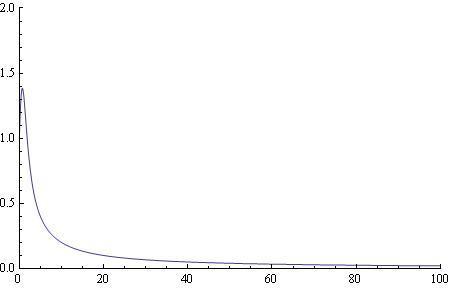

I think you need to more analyze the integrand in the domain of integration. For example, if I just choose a point (x,y)=(-pi/4,-pi/4) and then attempt to numerically integrate over t this is what Mathematica reports:

Wait a minute dude. Let's just plot it then:
Code:
Plot[myk[-Pi/4, -Pi/4, t], {t, 0, 100}, PlotRange -> {{0, 100}, {0, 2}}]
and also, use FindInstance to see if it ever goes below the x-axis:
Code:
In[23]:= FindInstance[
 myk[-\[Pi]/4, -\[Pi]/4, t] == 0 && t > 0, t, Reals]
Out[23]= {}
so at least initially, these results are suggesting the integrand when (x,y)=(-pi/4,-pi/4) is always positive and note if I just start integrating it from t=0, 100, then 1000, then 10000, then 100000, the value of the integral grows larger and larger. These results are leading me to believe the integral that I have input to Mathematica may indeed not converge but there is still a slight chance that Mathematica is wrong but it's not often.

Yes I think when x = y your integral goes to +Infinity and therefore Exp[-Integral] goes to 0 and that's what I mean when I said I expect it to go to zero when x = y. I really meant the exponential of minus the integral. So our calculations agree when x = y. Thanks for your help.
