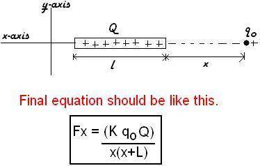

Find the force on a positive point charge q located a distance x from the end of a rod of length L with uniformly distributed positive charge Q. See Fig
Hint: divide the rod into slices of thickness dy and charge Qdy/L, find the force from each slice, and integrate from x to x + L …
what do you get? :smile:
