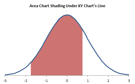

Now suppose that you want to calculate the shaded area in this graph:
Assuming that the boundaries are -1.8 and 0.8, the shaded area would be ##-1.8 \le z \le 0.8##. Can you express this entirely in terms of ##z \le \cdots##? Hint: you can start with ##z \le 0.8## but then you are taking too much, so you need to subtract that bit again.
