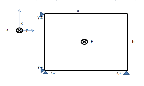

Hi,
Can anybody help me withg the following problem:
A rectangular plate with points starting from top left corner and going clockwise:: A B C D. Sides CD and DA are simply supported, and a point force F is applied anywhere on the surface. I am looking for the bending stress distribution in the plate.
I have looked in all the relevant textobooks and online, but have yet to come across an example of such a situation.
Thanks,
hushish
What a beautiful problem. I would have expected a very elegant general analytic solution.
Unfortunately, if a force is applied to a point then the infinite pressure will punch through the plate. For that reason the force must be applied to a small finite area of the plate. This upsets the analytic solution of your idealised model somewhat, it may explain why it is not found in the literature.
The obvious numerical solution would be to use finite element analysis.

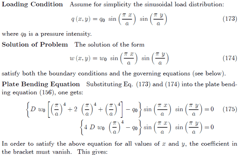

In general, while plate problems can be described rather elegantly, their solutions can be somewhat difficult and messy, even numerical solutions.
Take a gander here:
http://www.efunda.com/formulae/solid_mechanics/plates/theory.cfm
For small deflections, the plate problem is an example of a bi-harmonic problem. Except for a few trivial examples, these problems have to be solved numerically, using some type of finite element approach.

What you have is a mechanism (i.e. the number of degrees of freedom is less than the number of equations . As the only two supported sides are simply supported only (i.e. have no fixity). If the supports are truly supported and have no fixity the beam will simply be allowed to rotate at its free end.
If you have a FE program try it out and the analysis will fail. Even simpler, try a simple beam with only a pin restraining translation only in x and y directions. The analysis will fail.
Hi Henneh,
The following boundary conditions definitely do work in FE.
