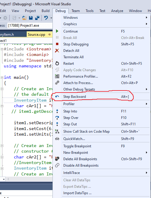

I don't see Alt[ in debug menu.
The debugger has to be running for this option to appear.

Yes, I was running debug by hitting F5 first and stop at the break point before I check. This is the picture. I don't see it.

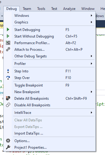

Possibly Step Backward is no longer a feature in VS 2019. I'm running VS 2017, and it is there, but only if the debugger is running.
Here's what I see when the debugger is not running.
Here are the options when the debugger is running.

Too bad, ha ha, maybe I should try to get the 2017! Believe me, I tried the alt-[ where it shows or not. It just gave me a "bing" sound.

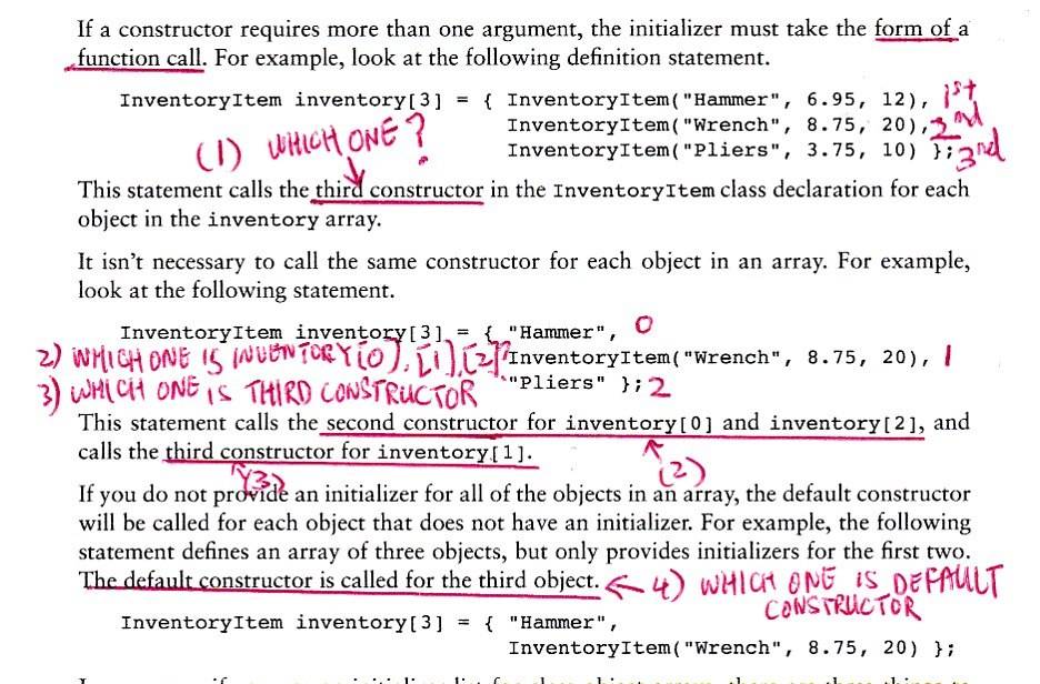

I might have an English problem here. I read this CAREFULLY like 10 times, I cannot make heads and tails out of this. The question is written in the copy. I have no idea what the book refer all the 1st, 2nd, 3rd constructors etc. I copy the two pages in the book. They are continuous from one page to the next.
I labeled question (1) as 1st, 2nd and 3rd. I labeled questions(2) and (3) as 0, 1 and 2. Please help clarify (1) to (4) for me.

For question (1), see Contents of InventoryItem.h (Version 3) on page 759. The "third constructor" is labeled "Constructor #3". It receives three arguments.
The statement that you asked about, is on page 761. It calls that constructor three times, once for each of the three elements of the array named inventory, supplying three arguments each time.
For questions (2) and (3):
The compiler chooses which constructor to use, by comparing the number and types of arguments that you give when calling the constructor, with the number and types of arguments in the constructors in the class definition. inventory[0] and inventory[2] are each constructed with one argument: a C-string. Therefore "Constructor #2" is used (because it receives one argument, a C-string). inventory[1] is constructed with three arguments: a C-string, a double and an int. Therefore "Constructor #3" is used.
For question (4), the "default constructor" is the one that has no arguments, in this case "Constructor #1".
Likes yungman
@jtbell explained this pretty well, but just in case, the constructors are numbered in the code you showed.
// Constructor #1

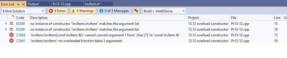

I am running into problem with VS again. If you look at the invItem.h, if I use line11 to line27. It will FAIL and the error file is shown below. BUT if you block out line 11 to line27, the USE line 29 to line 44. It will work. Look at the two blocks of codes. THEY ARE EXACTLY THE SAME. I compare the two blocks a few times. They are exactly the same.
This is the invItem.h.
C++:
#ifndef invItem_H
#define invItem_H
#include <cstring>   // Needed for strlen and strcpy
#include <iostream>
class invItem
  private:
    char* description; const int L = 21;  double cost; int units;
  public:
//This part of the code will give error
    invItem item1()
    { char cA1[] = "Alan";
      description = new char[L];//0
      strncpy_s(description, L, cA1, L);
      cost = 0.0;   units = 0;}//2
   invItem item2(char *desc)//12
    { description = new char[strlen(desc)+1];//13
      strncpy_s(description, strlen(desc)+1, desc, strlen(desc)+1);//14
      cost = 0.0;   units = 0; }//15
    invItem item3(char* desc, double c, int u)//18
    { description = new char[strlen(desc) + 1];//19
      strncpy_s(description, strlen(desc)+1, desc, strlen(desc)+1);//20
      cost = c; units = u;}//21/*This is the exact code as above. If you use this part, it will work.
    invItem()   // Constructor #1
        cost = 0.0; units = 0;}// 2--Default values
    invItem(char* desc)   //12   Constructor#2
        cost = 0.0; units = 0; }//15---Default value
    invItem(char* desc, double c, int u)//18-Constructor#3,No default value
        strncpy_s(description, strlen(desc) + 1, desc, strlen(desc) + 1);
        cost = c; units = u;}//21 --From main()
This is the end of the working code*/
    ~invItem()  { delete [] description; }//42, 43, 44
//Mutator function only for Constructor#1
    void setDesc(char *d) {strncpy_s(description, L, d, L);};//5--d=cAr1
    void setCost(double c) { cost = c; }//7
    void setUnits(int u) { units = u; }//9
// Accessor functions
    const char *getDesc() const { return description; }    //25, 31, 37
    double getCost() const { return cost; }//27, 33, 39
    int getUnits() const { return units; }//29, 35, 41
#endif
This is the source.cpp
C++:
#include <iostream>
#include <iomanip>
#include <cstring>
#include "invItem.h"
using namespace std;
int main()
{//Create invItem object item1, to Constructor#1, set default values
   invItem item1;
   char cAr1[] = "Hammer";//3
   item1.setDesc(cAr1);//4--to mutator
   item1.setCost(6.95);//6--to mutator
   item1.setUnits(12);//8---to mutator
//Create invItem object item2 with one parameter
   char cAr2[] = "Pliers";//10--input parameter to item2
   invItem item2(cAr2);//11--cost and units by default
//Create invItem object item3 with 3 parameters
   char cAr3[] = "Wrench";//16
   invItem item3(cAr3, 8.75, 20);//17 parameters for item3
   cout << "The following items are in inventory:\n";//22
   cout << setw(20) << setprecision(2) << fixed << showpoint;//23
//Display item1 use item1. to access member functions
   cout << "Description: " << item1.getDesc() << endl;//24
   cout << "Cost: $" << item1.getCost() << endl;//26
   cout << "Units on Hand: " << item1.getUnits() << "\n\n";//28
//Display item2
   cout << "Description: " << item2.getDesc() << endl;//30
   cout << "Cost: $" << item2.getCost() << endl;//32
   cout << "Units on Hand: " << item2.getUnits() << "\n\n";//34
//Display item3
   cout << "Description: " << item3.getDesc() << endl;//36
   cout << "Cost: $" << item3.getCost() << endl;//38
   cout << "Units on Hand: " << item3.getUnits() << "\n\n";//40
   return 0;
This is the error message for the block of line11 to line27.
Anyone can explain this?
  • #114
No they are not.
  • #115
Likes Vanadium 50
  • #116
Or he could look line by line.
"invItem item1()" is not the same as "invItem()"
  • #117
And "invItem2(char *desc)" is not the same as "invItem(char *desc)"
And "invItem3(char* desc, double c, int u)" is not the same as "invItem(char* desc, double c, int u)"
@yungman, you have forgotten the most significant thing about overloaded functions.
