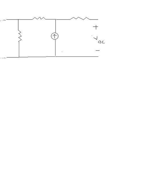

The discussion revolves around circuit analysis, specifically focusing on the concepts of open-circuit voltage (Voc) and Thevenin equivalent circuits. Participants are examining a partial circuit diagram to clarify the relationships between components and their contributions to the overall circuit analysis.
- Exploratory
- Technical explanation
- Homework-related
- One participant questions whether Voc is equal to the voltage across the current source.
- Another participant notes that the resistor in the circuit has no current and thus no voltage drop in its current state, but this may change when the circuit is fully connected.
- A participant clarifies that the problem involves finding the Thevenin equivalent and asks if the resistor to the right of the current source should be included in the calculations, given the assumption of an open circuit situation.
- One participant acknowledges a previous misunderstanding about Voc and confirms it is indeed the same as the voltage across the current source, while also stating that the resistor should be included in the Thevenin resistance calculation.
There is some agreement on the relationship between Voc and the voltage across the current source. However, there remains uncertainty regarding the inclusion of the resistor in the calculations, indicating that multiple views exist on this aspect of the problem.
The discussion does not resolve the assumptions regarding the circuit's configuration or the implications of treating the resistor as part of the Thevenin equivalent, leaving these aspects open to interpretation.
