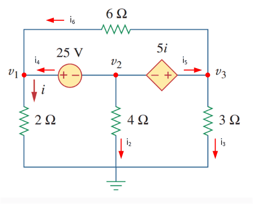

mkamalzayed said:
Depending on your assumptions
Node v2 does not receive any current
How do I apply the KCL law?
v2 receives i2, i4, i5.
i2,i4,i5 flows from v2
There are not currents entering the node v2
You are forgetting what BvU said in post #15: "No worries about the directions of the currents: the correct sign will come out in the analysis."
The arrows on the diagram may not be showing the direction of physical current flow. What if i2 has a negative value?
Proceed like this. First note that the 6 ohm resistor is connected across voltage sources so it has no effect on the values of v1, v2 and v3; remove it--that means i6=0.
Treating v1, v2 and v3 as a supernode means that you don't write 3 KCL equations for each of v1, v2 and v3. Instead you write one KCL equation for the supernode (the supernode being the combination of v1, v2 and v3). That equation expresses the fact that the sum of the currents entering or leaving the supernode sum to zero.
If i6=0, then i=i4 and i3=i5 so the 3 currents i, i2 and i3 are the only currents entering or leaving the supernode. So we have i+i2+i3=0. Can you express that equation using v1,v2,v3 and the values of the 3 resistors?
To finish you'll need two constraint eqations; I'll help you with those.

BvU said:
The diamond
represents a dependent voltage source of 5i Volts, where i is the current through the 2Ω resistor (
in the diagram).
Before diving into supernodes, you should first come to understand the diagram and why KCL says ##\ \ i_2+i_4+i_5=0\ \ ## (or ##-i_2-i_4-i_5=0##, which is equivalent).
