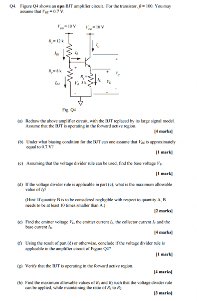

Hi,
My mid-term quiz is next week. I have tried to solve this question but I'm stuck on Qn 4 Part H. Any hints??
Image for Qn 4:

For part H, use logic similar to that used in part D. They are just different ways of stating the same concept.
