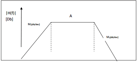

hello, i need to design analog circuit that has a transfer curve as seen in the following image using resistors, capacitors,voltage, and BJT (with beta value of 100).
the parameters are:
A=75
f1= 21Hz
f2=21 KHz
M1=40
M2=-20
the circuit also need to have input resistance of Rin= 60 kilo-ohm and output resistance of 51 kilo-ohm.

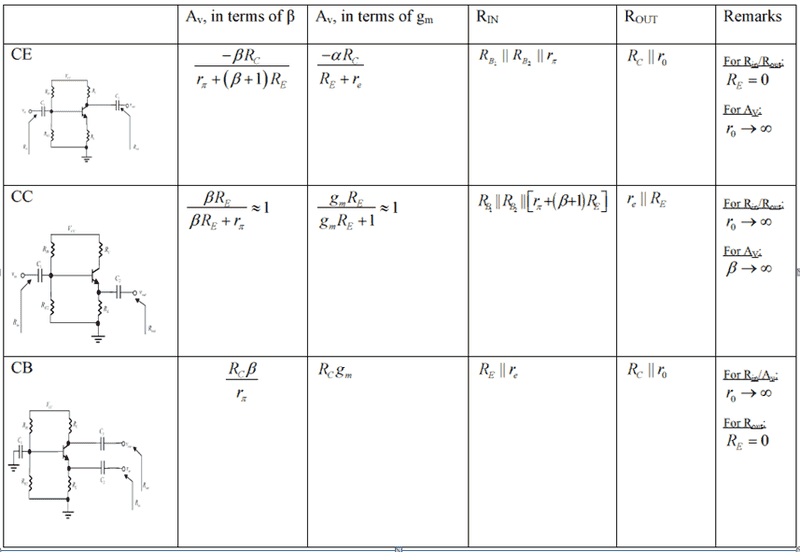

does my 3-stages solution make sense(see part 3:solution attempt)? is it the right approach?
how do I know which of the following modules should I use for each stage?
[/B]
i think the circuit should have 3 stages, each connected with a capacitor, where the first stage is for achieving the required input resistance, the second for the required gain, and the third is for the required output resistance.
(the first and last stages might also add some gain but it will be considered in the second stage)
f1 and f2 are the frequencies where the dotted lines are.
Well, which module(s) has/have the necessary gain?
Pick one or more and give us your first effort at a design.
M1=40
M2=-20
According to your diagram. one can get the impression that M1=20 and M2=-40 is required ?
Question: How do you intend - in principle(!) - to realize the corner frequencies?
