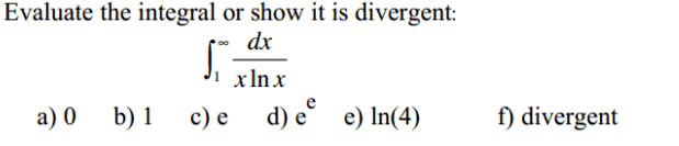

The problem is attached in this post.
Lim t -> ∞ ∫ dx/xlnx from 1 to t
u-substitution:
u=lnx
du=1/x dx
Lim t -> ∞ ∫ 1/u du
Lim t -> ∞ ln u
Lim t -> ∞ ln(lnx) from 1 to t
Lim t -> ∞ ln(lnt) - ln(0)
= ∞ - ∞ = 0 (This is incorrect since the answer is that the integral is divergent).
u-substitution:
u=lnx
du=1/x dx
Lim t -> ∞ ∫ 1/u du
Lim t -> ∞ ln u
##\ln(1) = 0##, not ##\infty##.
Anyway, never, ever use expressions of the form ##\infty - \infty##; these are meaningless and are illegal in mathematics.
That's true but it's not ln(1), it's ln(ln(1)) which is ln(0), which is equal to ∞, right?
OK, you're right. However, ##\int_a^b dx/(x \ln x) = \ln \ln b - \ln \ln a \to \infty + \infty## as ##a \to 1+## and ##b \to \infty##. As ##a \to 1+##, ##\ln a \to 0+## and so ##\ln \ln a \to -\infty##, or ##-\ln \ln a \to +\infty##.
Is there another way to prove that this integral is divergent? (For example, would the Direct Comparison Theorem work in this case?)
Also, why is ∞ + ∞ mathematically allowed, if ∞ - ∞ isn't?
∞ - ∞ is meaningless (along with 0/0, for example). ∞-∞ can be made equal to anything you want---anything from -∞ to +∞ and everything in between. However, ∞+∞ = +∞ is unambiguous. Think about it and you will understand why.
So ∞-∞ is an Indeterminate Form then right? So can I just L'Hopital's rule to solve for the limit instead of the other method that you showed in your previous post?
So by using L'Hopital's rule, could I take the derivative of ln(lnx) - ln(ln1) and then try solving for the limit etc.?
You keep missing the point: you do not have an indeterminate form, and do not need anything like l'Hospital's rule. I suggest you look much more carefully at what you are doing, and don't rush. Anyway, I already showed you a correct argument, but for some reason you are just not "getting" it.
Ok, I think I now understand your explanation, however would it also be possible to prove this integral is divergent via the Direct Comparison Test? And if it is possible, then how would I prove that the integral is divergent via the Direct Comparison Test?
